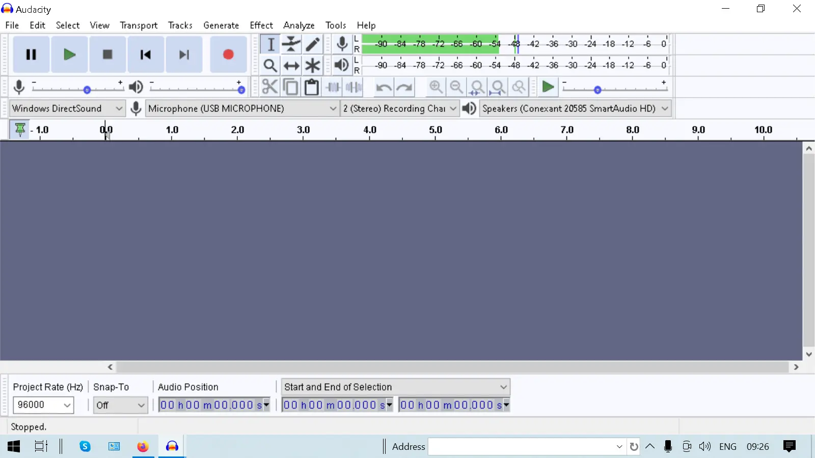

I'm bek! Attached is a screen shot of Audacity with a Citronics USB mic connected to this Lenovo laptop. I don't have a USB mixer any more but the principles are all the same for any "generic USB Audio device" (muktitrack USB interfaces with ASIO drivers do diff')
Note, on the top left "Windows Direct Sound" is the driver and next is the name of the device but that could be anything! Your mixer might show up as a "USB Microphone" or just "generic audio device". There is an input gain slider, pretty unique to Audacity, make sure it is initially set all the way right 100%, adjust when sorted.
Assuming the above is set OK you need to open a new session and click on the meters to show modulation. You need to get a signal averaging around -18(dBFS).

My first question would be do you have the Alto Truemix selected as the recording device in Windows? Under Settings - Sound - Input Devices, you can have different devices for playback and recording. If you are using the Windows Sound Devices driver, then you need to choose it there, then select it in Audacity or other recording software.
Fair point Rich. I would have gone there had the OP come back and said Audacity cannot find the mixer. Also, in my experience Win 10 at least defaults to a generic audio device such as a USB mic or the USB A/D,D/A dongle I use with a headset for Skype. Much of the time this laptop is running with MOTU ASIO drivers for an M4 but if I swap that for either of the other two devices I do not need to change anything in Win Sounds.
