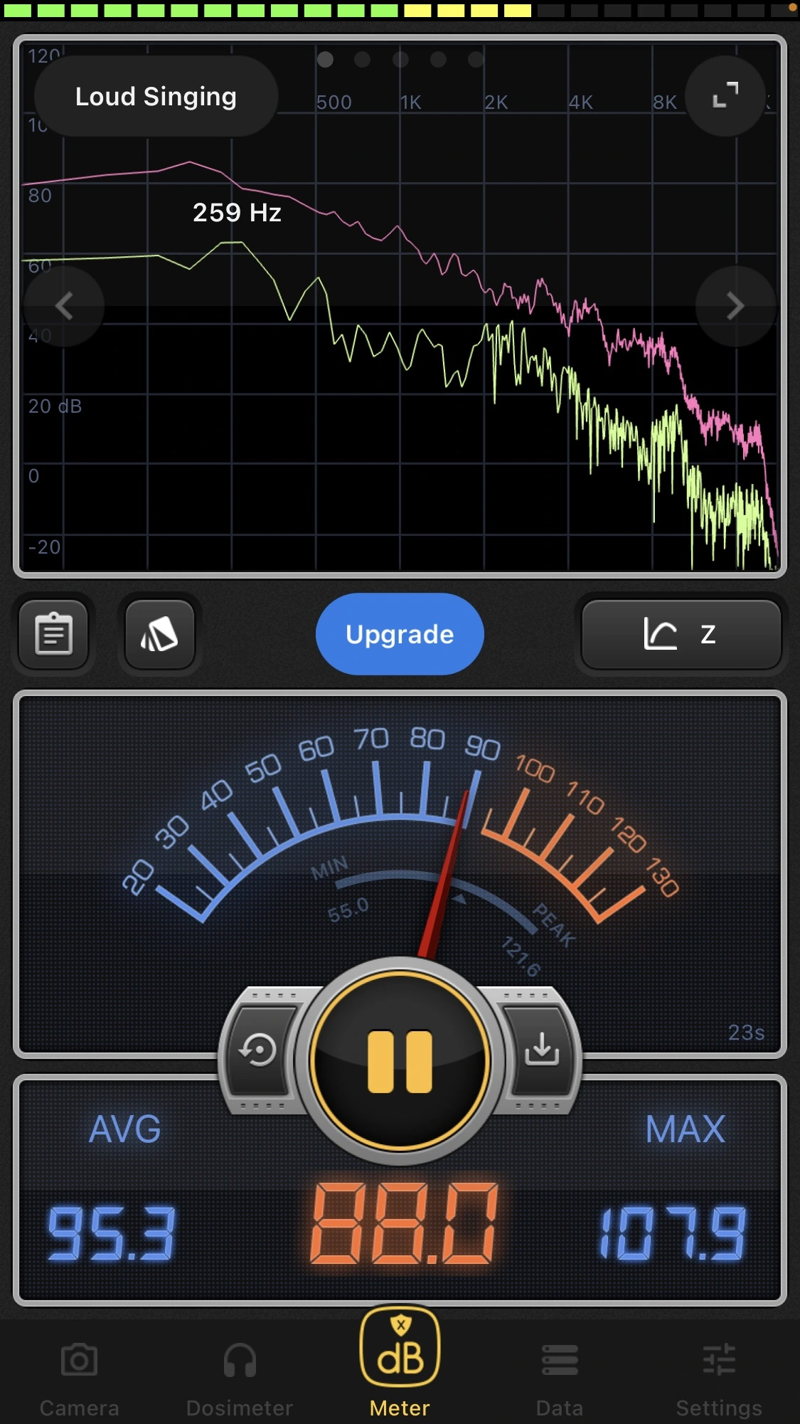

Dave - how weird we both like Tannoys. I had to downsize my studio in 2004 on a move and I sold (stupidly) my 15" Tannoys - a bad decision. I just sat on some steps here in the theatre A speaker very close and the phone app said the peak was somewhat loud! My ears told me that!
It's always over sensitive to bass - but to be fair, that's my phone I think.
