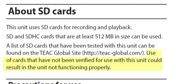

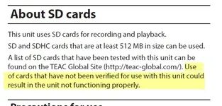

Thanks for replies guys - SD card is fine . . i get this without recording.. just listening to the keyboard straight through the Tascam, just a simple straightforward line in, thing is, i had no problems like this on the Neo i had previously. Putting it another way, the sound comming out of the keyboard is altered when going through the Tascam. I put 'recording bug' in as i cannot really record proper untill i get this sorted out.
