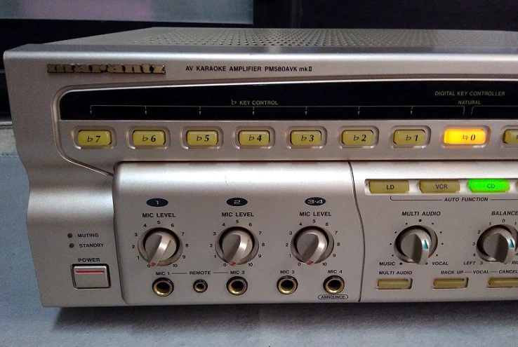

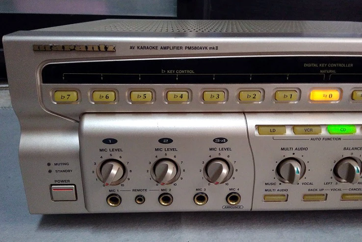

hi guys thanks for your prompt reply, I'm using the mic with this Marantz PM580AVK MKII amp

The PM580AVK has 1/4" TS jacks which are 'unbalanced'. The XM8500 mic has an XLR connector (balanced). Is the cable you are using an XLR to 1/4" TS(tip-sleeve)? If using a cable with a TRS(tip-ring-sleeve) to plug into the Marantz, there's a possibility something may not connect properly.

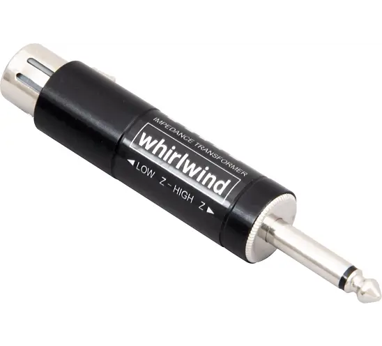

I am thinking that the jack plug mic input is a HighZ input and the Behringer is a LowZ mic. Try using one of these. Any brand will do.

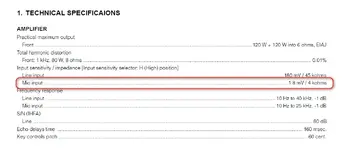

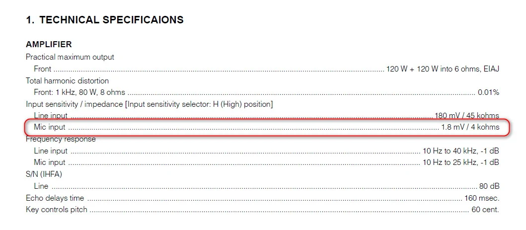

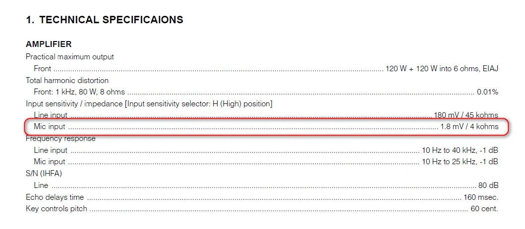

I was originally thinking that as well, but the amp service manual shows the mic input being 4 kohms which should be OK for most low-z mics as long as the mic truly is something better than -70dB / 0.3mv/PA sensitivity.
