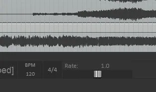

Did you somehow hit the "Rate" slider next to the BPM indicator? I did that one time by accident and wow!! did it ever mess with my mind. If you slide it left or right it will change the speed of playback and the pitch, like speeding up or slowing down a tape.
I'm pretty sure I didn't hit the slider, but I will double check.
