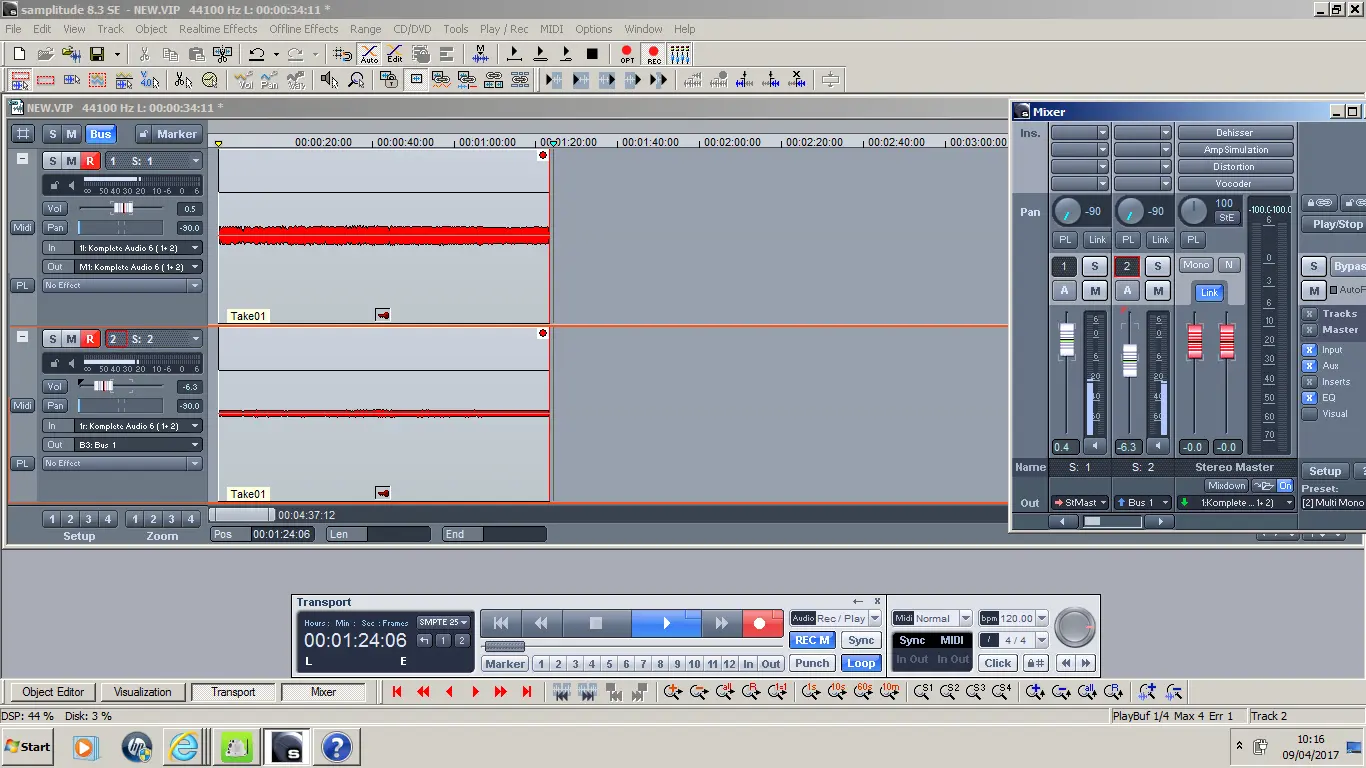

As shown, changing the faders in the mixer (Samplitude SE8) changes the level written to the DAW but not any of the meters.
Windows (7) Sounds has an input level control but it is buried and hard to use and also operates on the stereo pair.
I would think any kind of 3rd party software would have to somehow access that Windows driver. Where else in a DAW is there software control of input level?
