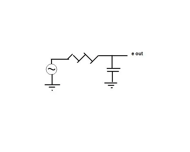

Calculate the capacitive reactance when C=2mF and f=100Hz...
Would it help if I said I don't know whhat the fuck I'm doing?
HELP!
the formula is 1/(2*pi*f*C), i think. so.. uh,
1/(2*pi*100*(2*10^-3))
came to like .796
I don't know what the fuck i'm doing either.
Edit: is that mF micro or milli?
Yeah, that's the right formula. The 3db cutoff frequency of that circuit (low pass filter) is essentially when the reactance of the capacitor becomes equal in magnitude to the resistance of the resistor.
Ok this is the formula I got...
Xc= 1/2*pi*f*C
I think I'm on the right track but I'm not sure what "C" is...
I came up with 795.7747155
my "m" = micro farat which may be whats wrong I don't know.
Xc= 1/2*pi*f*C
yeah, if you use micro, you'll get 795.

OK heres a differant type problem with the same circuit...
Calculate the voltage at e out when R = 270 Ohms and E in = 12 V
Z = R + jXl -jXc
Yeah, it's something like that (i've "misplaced" my memory of the exact formulae- I'm a firm believer of deriving things from first principals)
However, this totally neglects the fact taht this is a complex function.
Becuase you've got an oscillating supply, and a phase/frequency dependant component (the capicitor) you've got to factor in that little i (you know, the sqrt(-1) fellow).
If you ignore the complex part, then you get these simple equations like Z = R + jXl - jXc, which I think comes from something like Z = R + jcis(fl) + 1/jcis(fc) or some crap like that. If you're doing simple electronics for homework, then the equations you're loooking at will be fine.
