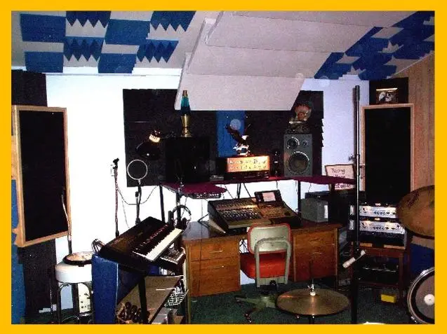

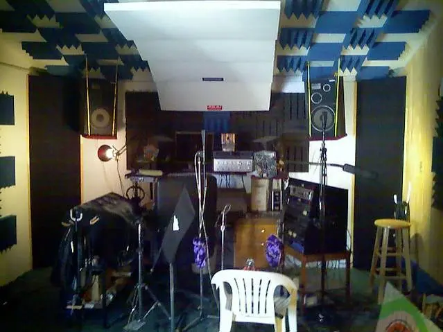

Im an ex-spurt
So I've been working with this set up for a few years now .....
the 2 traps in the corners in the first pic, along with the chunk type foam above and below em have been taken out to be replaced by the corner traps I'm gonna build next.

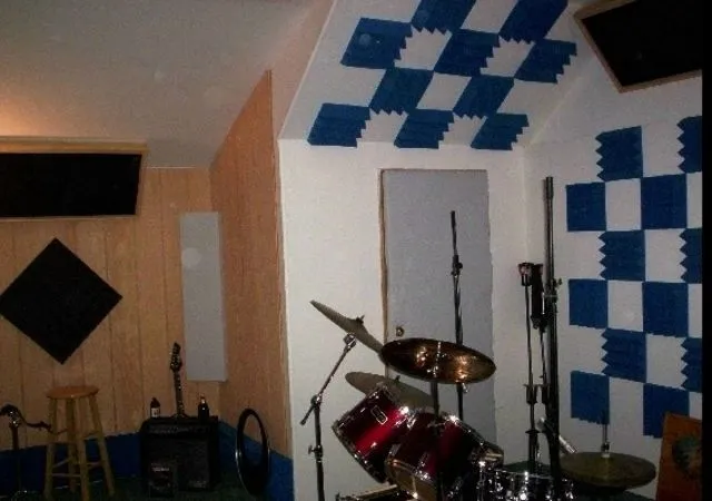

The 2nd is just the back of the room behind my desk.
Small room...16 ft wide....18 ft at the depth of that "cove" ...14 ft deep at the door.
Ceiling peaks at 10 ft 6" and wall height is 7 ft 9"
Bein as how it's so squarish (:o ) I figgered more trapping was in order.
Anyway...I'll post some progress pics so far and then when I get the corner traps done.
peace-n-shit. :D

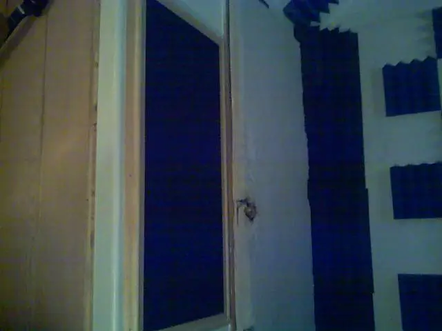

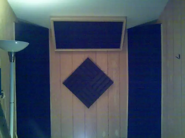

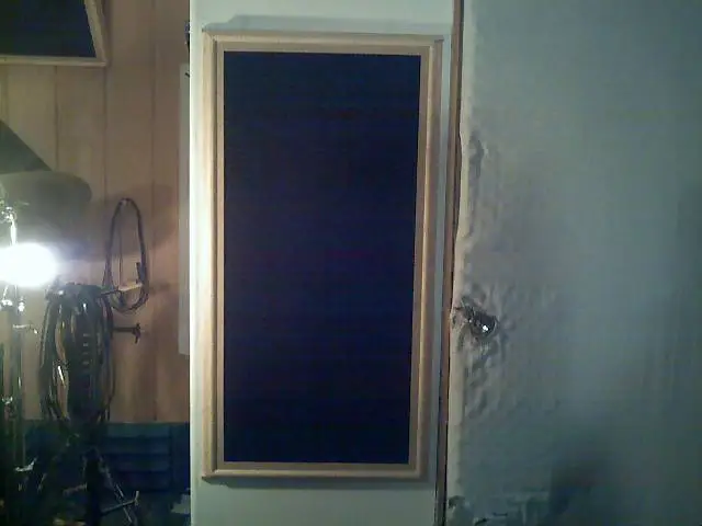

one of the traps I swiped from the front corners.
Tryin to get some trapping directly behind my mix desk.......which happens to be the corner here....:o
where I put the foam chunks from the front corners and another view of the flush mount trap.

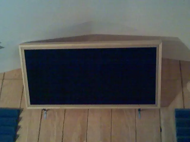

And the other trap I swiped from the front corners and mounted what's gonna be above and behind (kinda) my drums

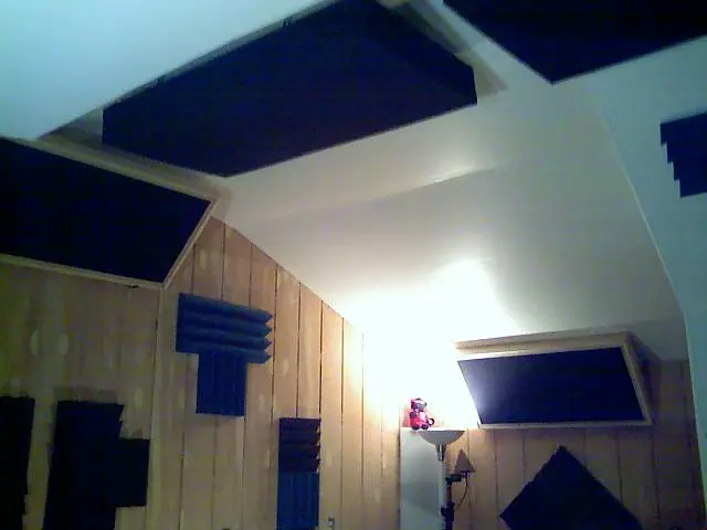

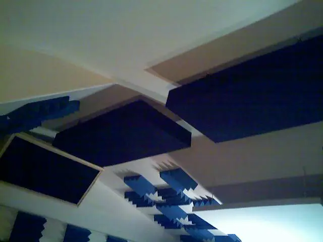

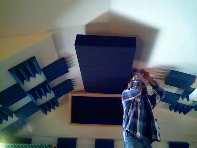

hangin the ceiling traps (244's from GIK :D) and tweakin the height.
I guess they're right...:o
another shot of the ceiling.

wow u got a lotta treatment in there, looks nice!

Looks good...nice job hanging the 244's on the ceiling.
Frank
Frank
Thanks man....the 2 different angles of the ceiling taxed my few remaining brain cells tryin to get em right. They're a bit crooked but I'm not that particular.

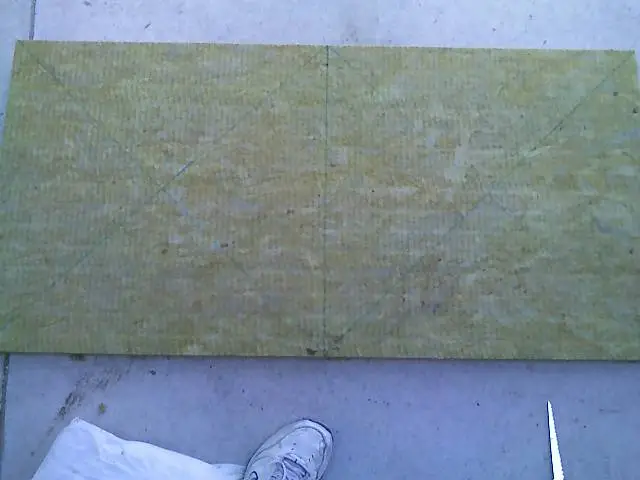

Corner traps are done! :drunk:
12 hours on Saturday between cuttin the insulation and fixin my sprinkler system then another 9 hours Sunday cuttin fabric, doin the trim and the clean up afterward.
The first pic, you can just make out the X's that will make the triangles. They're 17" down each side with 24" across the front.
All said and done it took 178 triangles to do all 4 traps.
I found it a better and easier cut if you cut along the line with a utility blade first...then saw thru with a fine toothed hand saw.
