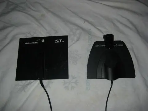

Is it the new one or the old one? The former is not the same as the latter which was actually made by Crown. The new one is a different design.
Old on left, new on right.

I'm not even sure that the new design is really a PZM (see my pic above). But the old ones have been out of production for at least 10 years, probably longer.....

Well yeah, those are my mics in that pic! The new ones sound very similar, though the high end is not quite as detailed.
