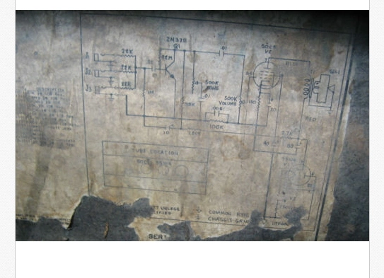

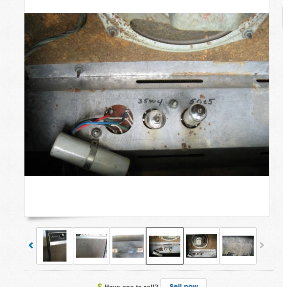

It's a 50C5 power output tube. My old Hickok tube tester didn't list a 50C3, so I got suspicious. the 50 is the filament voltage and usually the last number signifies the number of elements in the tube, 3 or 4 is usually a rectifier and 5 or 6 is a pentode which the power out tube would generally be. The filaments of the tubes are likely run in series (50+35=85 volts) with an additional resistor (250 ohms in schematic) to drop another 40 volts. The 50C5 and 35W4 were common tubes in old radios and should be found fairly easily online, but not at a music shop. If the amp has a two wire cord, which I'm guessing it does, get it converted promptly to a proper 3 wire grounded one (unless you enjoy getting shocks).
Found an eBay listing which had some pics VINTAGE 1960 039 s KAY MODEL 752 GUITAR AMPLIFIER SILVERTONE | eBay

Oh, thanks! That's great news. I was starting to think I'd be shit out of luck if anything ever happened to the power tube.
And actually, the Reverb listing you linked to is the exact amp I bought. That's not the listing (that ended 11 months ago), but it's the same amp (someone bought it and is selling it now I guess), and the same exact pictures were used for the listing.

The schematic shows a single transistor for the preamp stage in the frontend followed by the power amp tube, so it's a hybrid.
