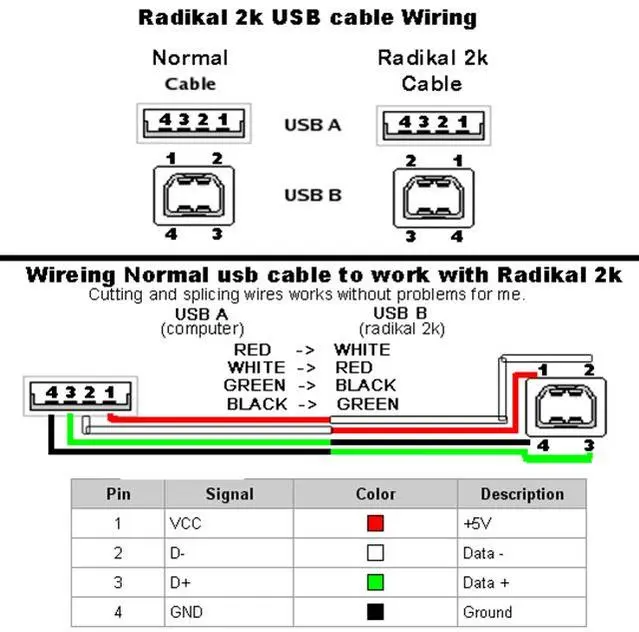

Hey guys after searching around for proper USB cable for my RADIKAL TECHNOLOGIES SAC-2K and having ZERO luck, I took out a pair of wire cutters and went at it with a regular printer type USB cable.
I was able to connect and use the 2k and update the firmware.and after a configuring it properly in Cubase and REBOOTING the PC it works well.
I had a couple requests to post up what I did so without further adieu here is the usb wiring diagram with normal cable conversion.
P.S. I am not responsible if you fry your USB port or something. Dont do this mod while your cables are plugged in!
