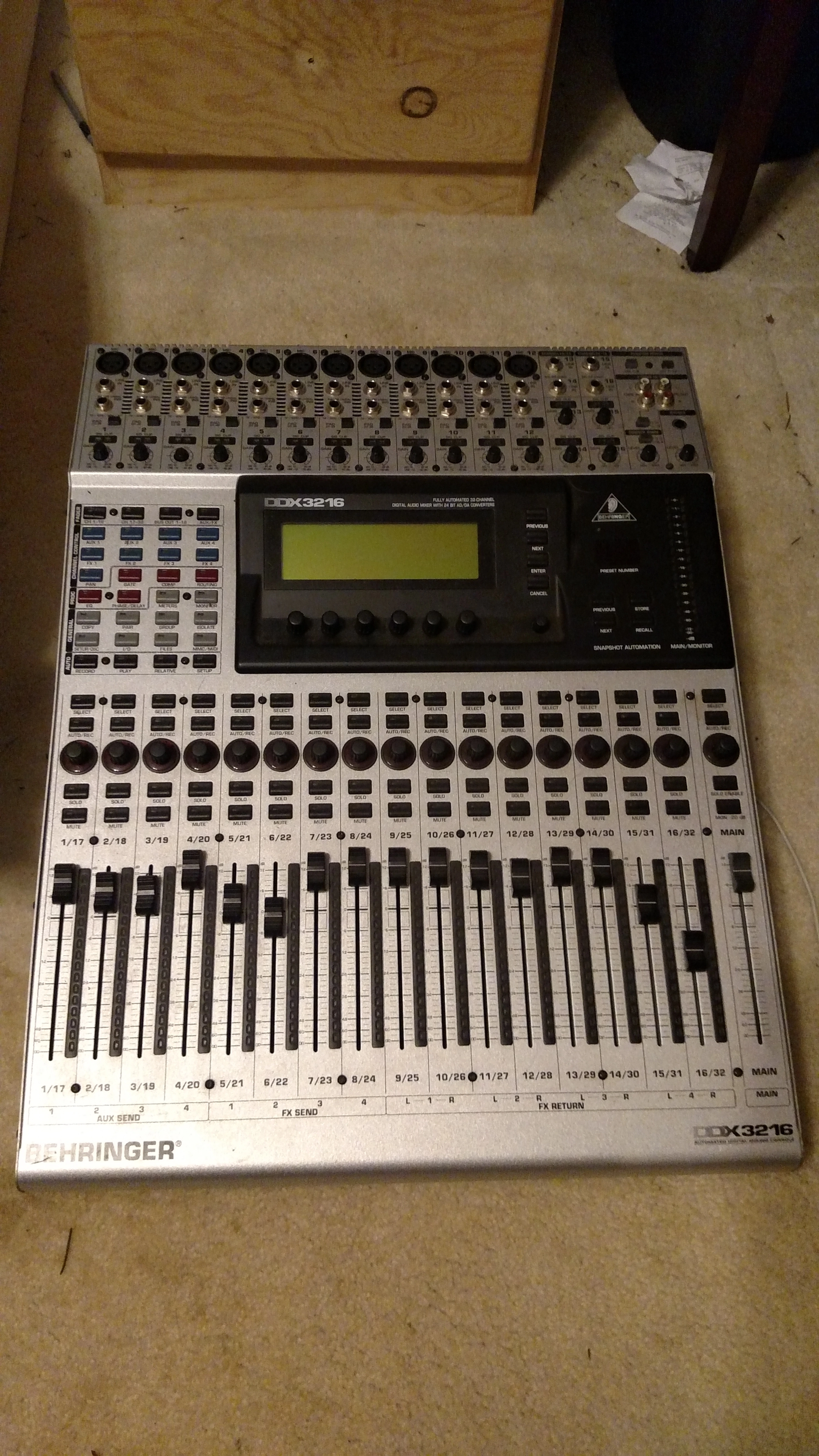

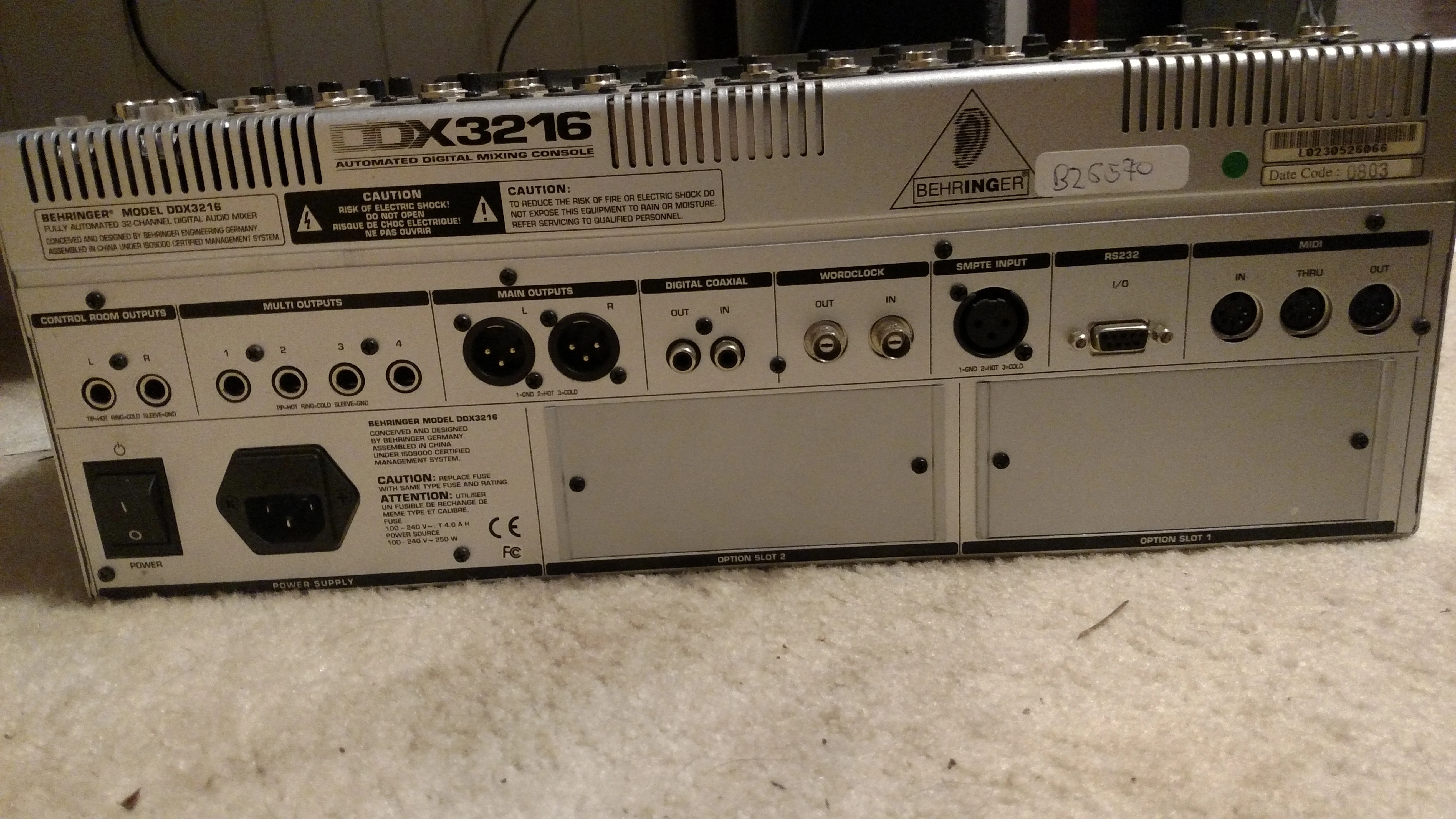

Hey guys, thanks for checking out my thread. I have a Behringer ddx32-16 mixer, but I'm not quite sure how to hook it up to my laptop. I would assume I need some sort of RCA to a USB cable....but I am not sure. What do you guys think?

The RCA connectors carry SPDIF/digital audio signals...so you would need to get some sort of conversion box that will go from that to USB.
You would probably also want to connect the Word Clock to maintain sync between the computer and the mixer ...but laptops don't have that...so IMO, it would be best to just get an interface with RCA/SPDIF and WC options.
Read your manual...that might give you more clarity about the connections on the back of the mixer.

You will only be able to record the number of simultaneous tracks as your interface has channels.
IOW...you could have 24 channels on your mixer...but if you interface only has two...then you would have to sub0mix those 24 mixer channels down to two, and you would end up with them being all recorded onto two tracks.
Now that may work for your situation...but I only mention that since most people assume one microphone = one recorded track.

you could use the mixer to submix inputs, say you wanted to record the whole band, you could run your drums into the mixer, mix them and send the left and right outputs from the mixer to your interface and use the other 6 channels on the interface for other inputs. took a quick glance at the manual, looks like you have 4 outputs you could use to run to the interface. it also has ADAT which is pretty cool. it looks like a pretty good mixer. I will do some more reading on it.:thumbs up:
