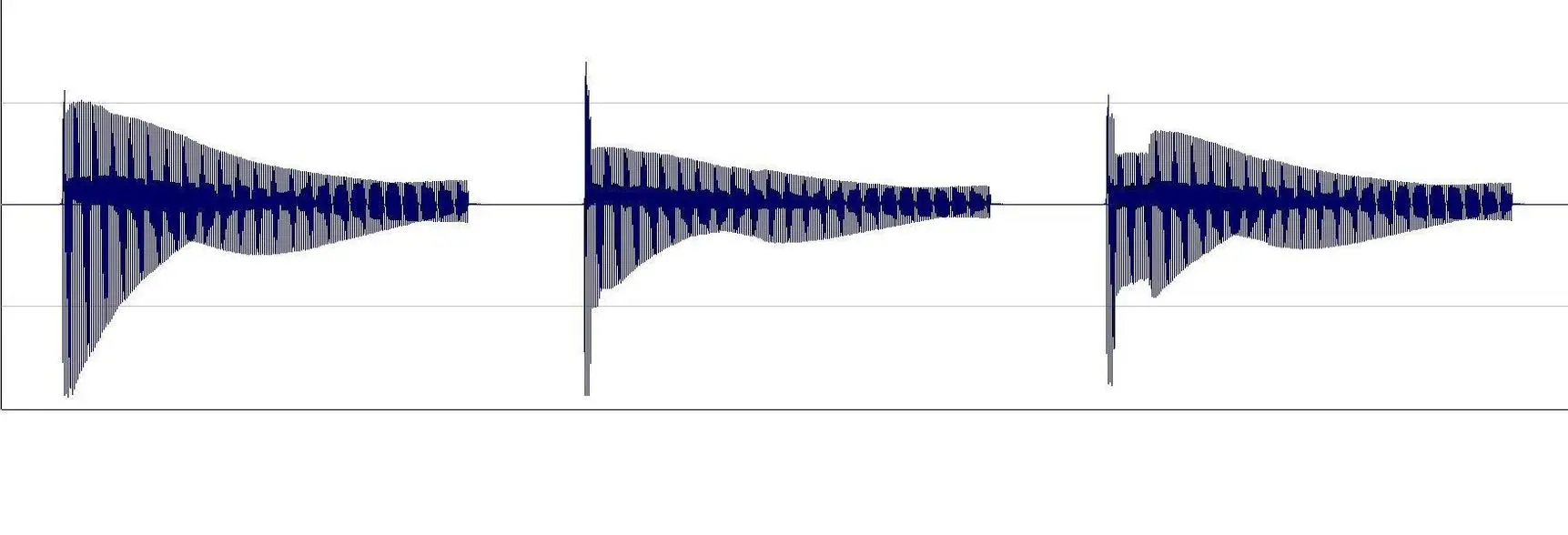

I don't know about those specific songs but see if this helps
The attached file (bass example) is a bass note looped, and I've used some extreme settings to make it obvious, and it was all done on Reapers built in compressor
first time it plays there is no effect its just the recorded note
Second time it plays is an example of what I would call using compression to get "Punch", the compressor is set fairly slow to let the transient through but then clamps down hard on the tail of the note so the attack of the bass note is now much more emphasised than the decay
Third time it plays is what I think of as "pumping/breathing". The release is set so fast so you can actually hear the compressor let go and the note volume snap back with a bow-wow kind of effect
I may have interpreted the slang wrong, who knows with such subjective audioterms?
there's also a snapshot of the wave form which might help you visualize what the compressor is doing to the sound
