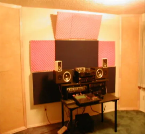

in progress..absorber panels for 13x13 ??
Front Wall:
completed 3qty. 703, cloth faced absorber panels per the drawings from the links. thanks again.
(2qty mid-bass= wall-1"air/703 2"/1" air/ cloth front)
(1qty upper-bass= wall/ 703 2"/ 1" air/ cloth front)
also added 2qty Foam-Eggshell pads 2'x2' squares for the Hi-Mid Freq ranges. I'm collecting these from the shipping garabge as I can...hey its free!
REAR WALL:
Wall-2" air/ King size mattress upright/ 1" air/ comforter (7ftx6ft)
pretty fhkn cool project so far.
the cloth fronts were a pain...
