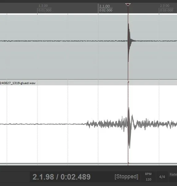

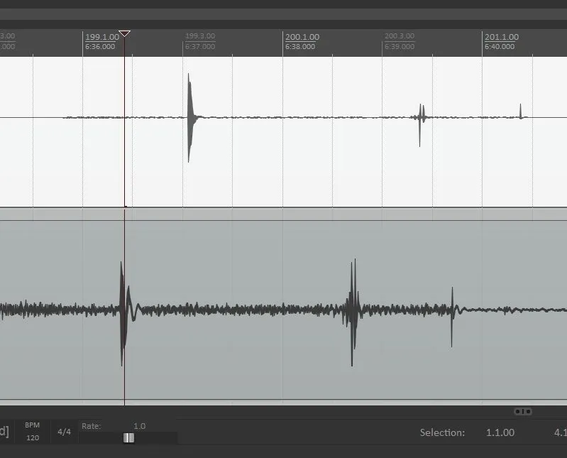

Just thought I'd add an update to this in case anyone else was dealing with similar issues, since I've hit on an interesting way to utilize both digital and analog in what I'm doing.
After playing a lot with other tape formats, I've continued to be drawn back to the 4 track cassette format for a variety of reasons. I don't have any use for digital as a recording format any longer, but I've found it makes an excellent *guide* or "map" for the tracks since it has no speed variance the way tape does.
So basically, every time I record a track on the tape machine now, I am simultaneously recording a track to the DAW as well. I then use the DAW tracks as a guide to line up the tape tracks after I import them. It's a pretty quick and easy procedure and once everything's lined up I delete the DAW tracks. Simple! It allows limitless tracks that are all fairly easy to line up.
This may well be a known trick, but oddly I haven't seen anyone mention it anywhere. It doesn't accomplish my goal of having no screens at all involved in tracking but it feels like a comfortable compromise.
Hopefully all this babble is helpful to someone.:)
I have a vision now of somebody with a classic car getting a friend to also drive their brand new car on every journey just in case the classic car breaks down on the way, so if it goes wrong or starts to rattle, you can still get home?
