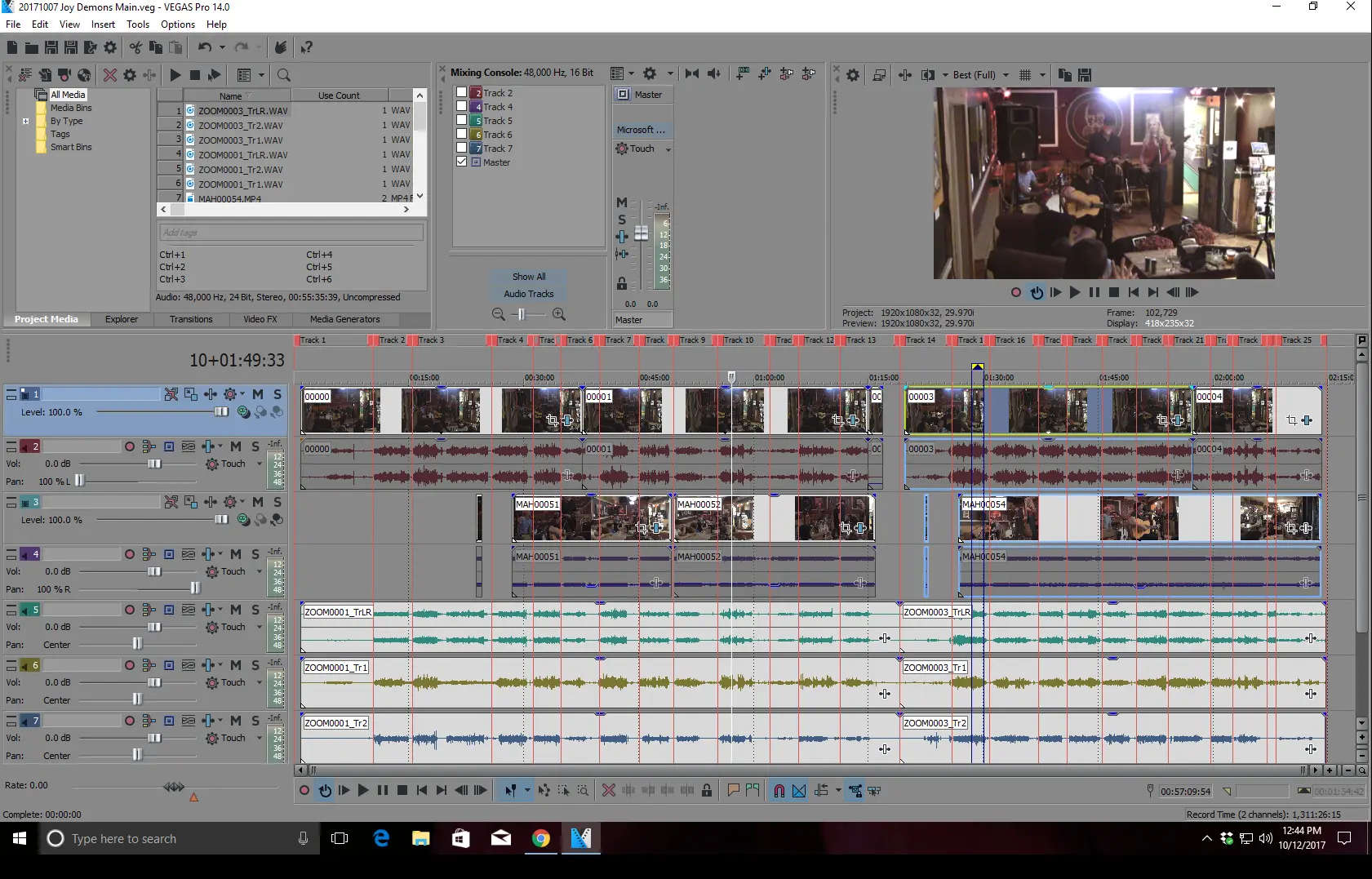

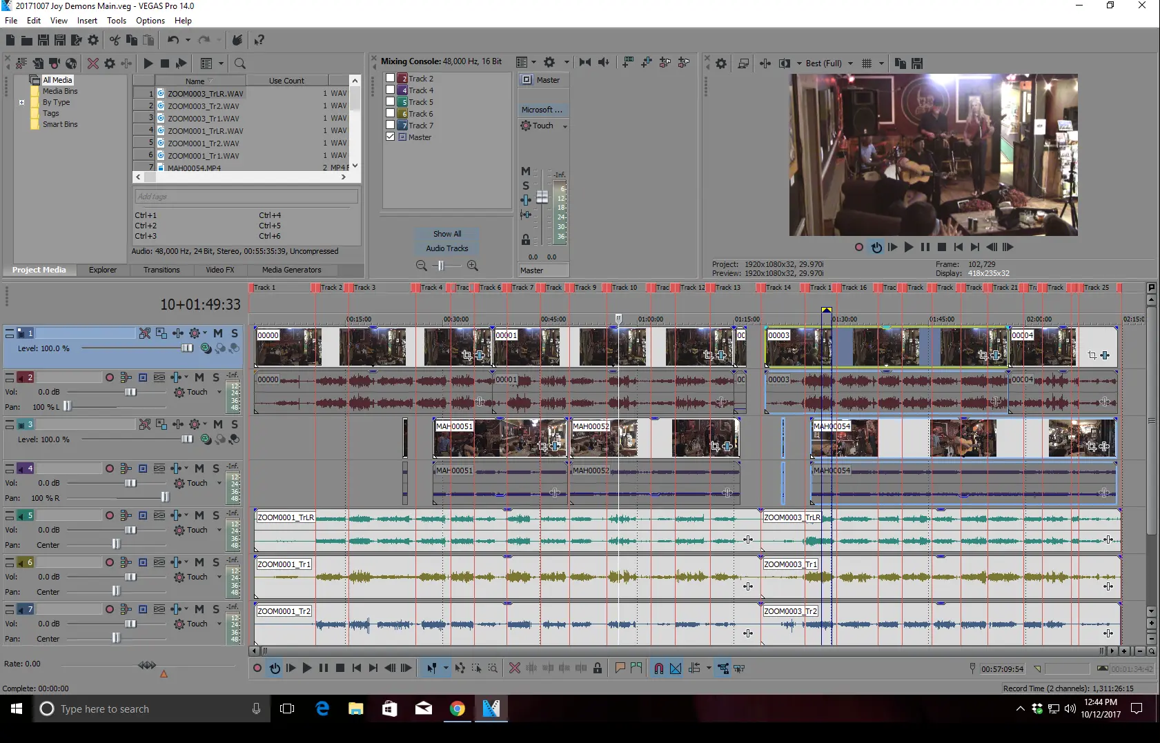

Here's a project I'm working on right now. I used the on board mics to capture the stage sound (drums amps) and audience and the two mic/line inputs to capture a mono feed from the PA and a direct from the bass. I had two cameras, one clamped to a shelf at the back of the room with a set wide shot and one for pan/zoom work. I use the camera audio as a reference to get things approximately in sync, then fine tune the sync by eye.

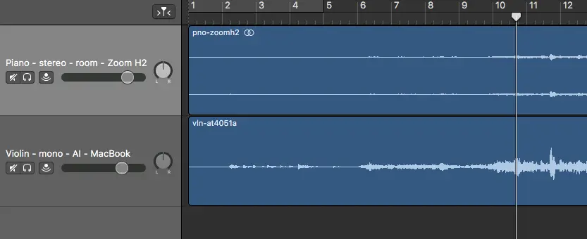

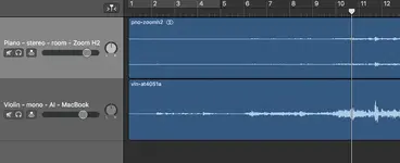

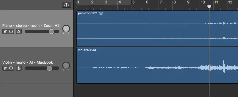

[MENTION=103008]bouldersoundguy[/MENTION] has a great solution - an H5, using the built-in mics for the piano/room and a single mic on the singer. Mix in a DAW, and sync to the video, eliminating the camera mic. I do this all the time anymore.
Way back when, I had to do this using a Zoom H2 on the piano and a single mic going through an interface into my MacBook Pro. Mixed in GarageBand (updated project pic attached). The results were more than good enough and I didn't have any significant clock drift, but using a single device would eliminate that concern entirely. Very short, highly compressed clip from that project also attached.

I do it something like that when the audio and/or video is more involved. On a recent video I had 16 tracks of audio and 3 camera angles, so I did the audio mix in a separate project and imported it into the video edit project as a stereo audio file. But with only 7 audio and video tracks on this project I decided to do it all in one. Vegas Pro is about as good a DAW as any, and it's a full featured video editor as well.
I've found that the camera audio sync isn't always quite on, so I only use it to rough in the sync and then I fine tune it by eye/ear/hand.
