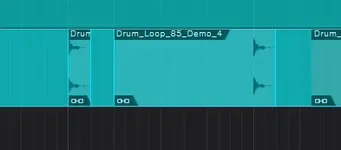

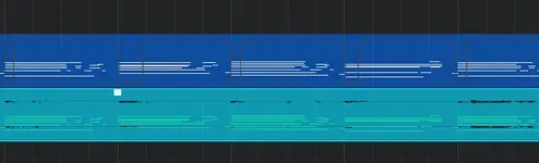

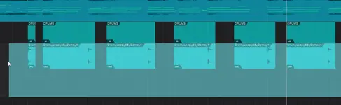

Here's the selection problem in pictures.
3.jpg shows the clips selected AND highlighted - the G key will now merge them.
2.jpg shows I have selected the clips (from below) but they are not highlighted - the G key will not merge them.
1.jpg shows I have selected the clips (this time from above) but they are not highlighted and G will not merge them.
Why does the selection not select the stuff each and every time? I'm spending a stupid amount of time just trying to merge clips.

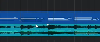

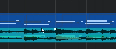

I checked my explanation and it's good. But here's the problem in pictures.

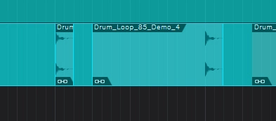

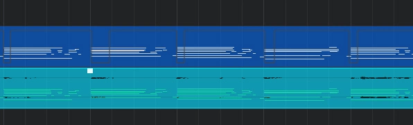

1.jpg The audio display on the bottom light blue track is barely visible. This is changed by placing the cursor close to the top of the track/display, where it will change to a pointy finger. When you see the pointy finger, you push the cursor up and the display and the volume are changed. The result is shown in 2.jpg.
What's bugging me is that it doesn't work all the time. I only tried enlarging the view to see if pointy cursor was a function of track size.

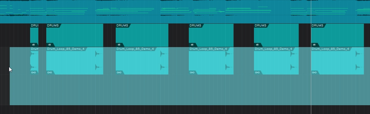

I stumbled on the answer to 'Selection works sometimes but not all the time.'

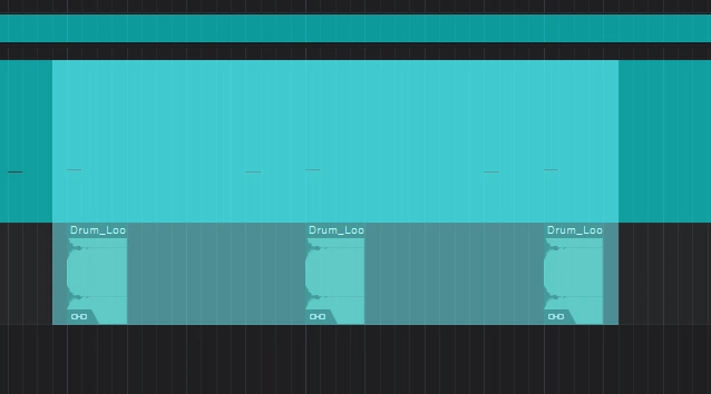

Selecting in the Track view DOES work! The important part is where you place the cursor. If you place the cursor higher than halfway up the clip, nothing is highlighted and G won't merge anything. If you select starting from below the halfway point, everything is selected and G will merge the selected content. So, you don't need to Shift/click each measure and you don't have to do it in the Edit window.
In Cursor too high.jpg, my cursor is above the halfway point in the height of the clip - won't work
In Cursor correct.mpg, my cursor is below the halfway point in the height of the clip - everything will be highlighted and G will merge the selected content.
It's probably in the manual but if I read the whole thing I wouldn't remember more than 5%! :)
