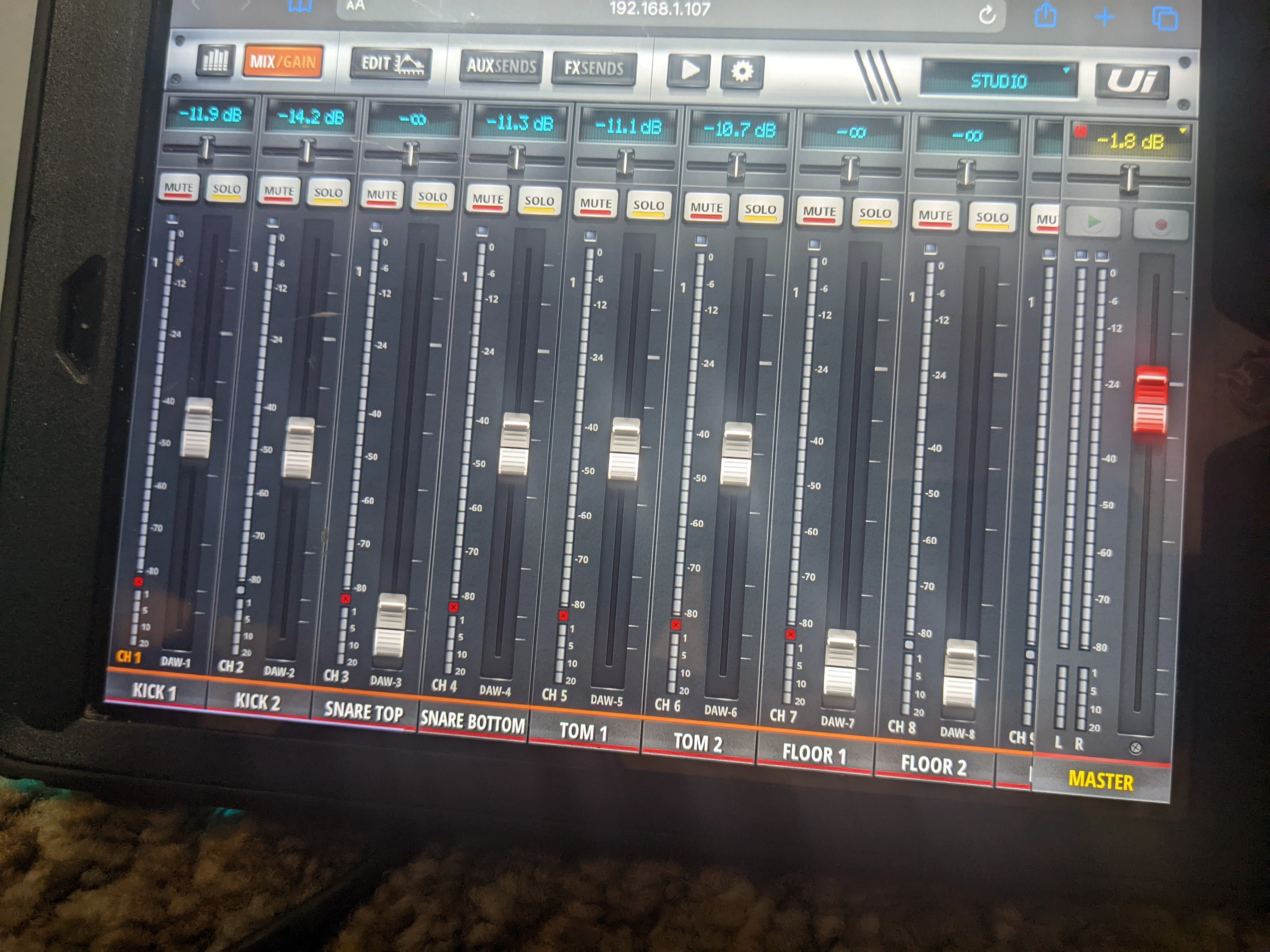

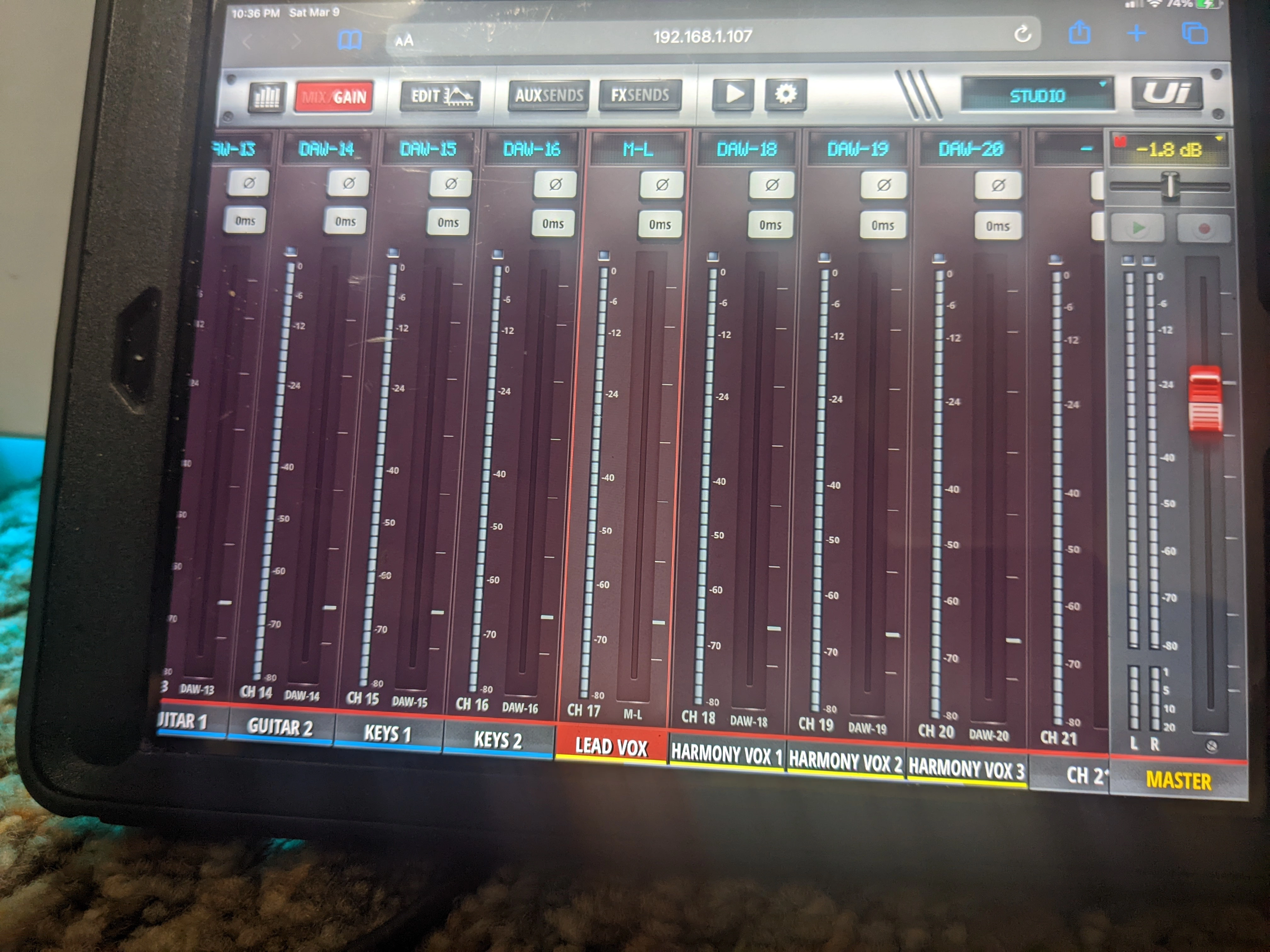

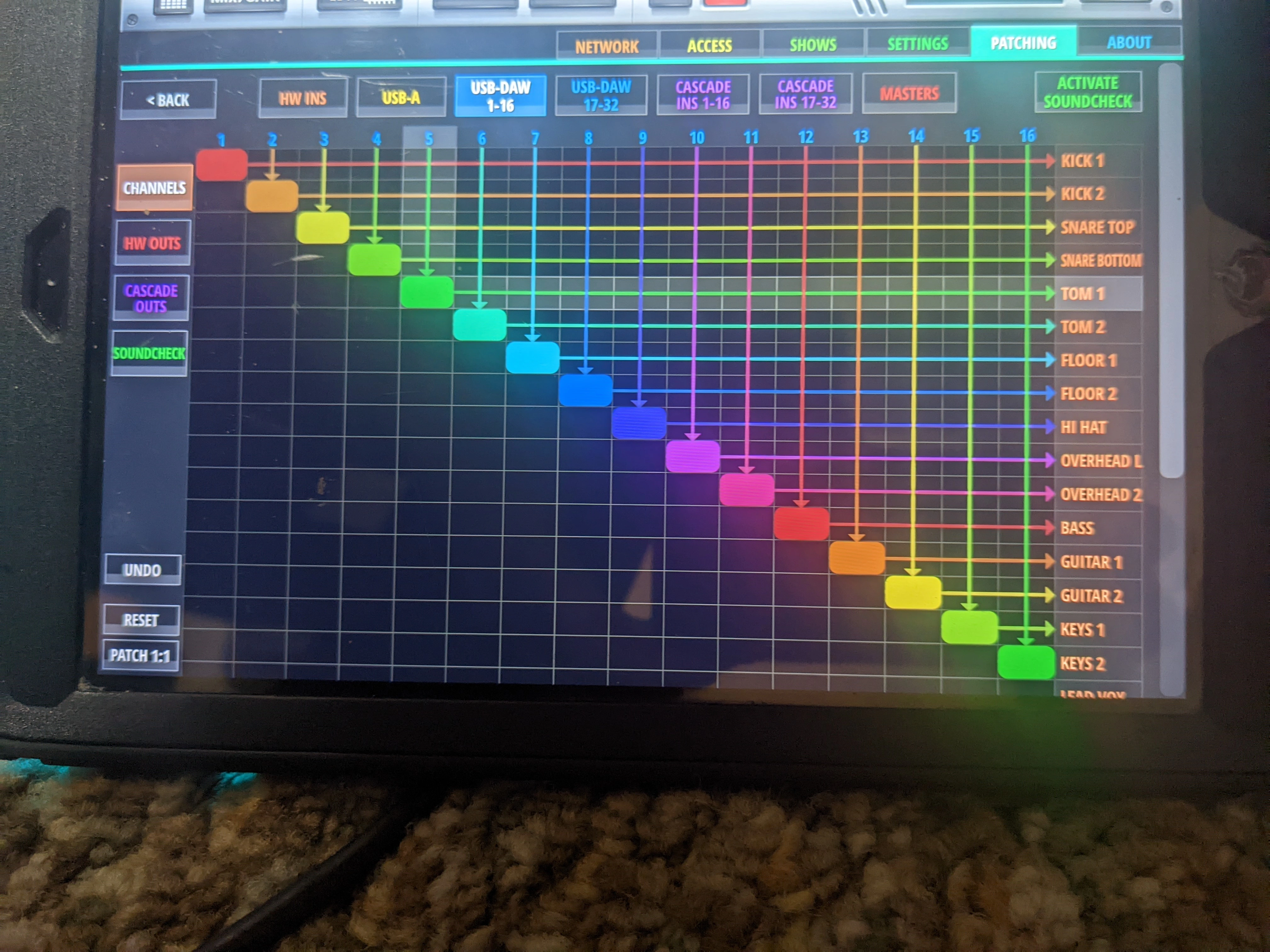

So I am working on getting everything set up. ProTools is installed and ready to go. I have watched a few videos on how to set up the Soundcraft ui24r for DAW and I keep running into an issue with my gain page. When I set the channels like they should be the Mix page has faders, but the gain page doesn't. What am I missing? I can't figure it out. I followed the video step by step and I end up with no faders on my gain page. Hard to set gain with no faders. I have no signal at all. I rebooted my iPad and router and it's the same. I am missing at step, but I don't know where. Thanks!!PXL_20240310_033532359.jpgPXL_20240310_033601188.jpgPXL_20240310_033607911.jpg
I found out there is a 2nd set of gains and phantom power if you scroll to the right up past the regular inputs. I still have no signal using those gains. Obviously I am missing a step somewhere. That and ProTools doesn't recognize an output choice on the track I created. I would appreciate the help. Thanks!!
Yes I have the inputs and outputs set up correctly. I did find the answer after searching for quite some time. You have to go to Settings> I/O> Outputs> Bus (tab)> click Default button. All the inputs loaded up and I was able to record and play back. None of the videos I found online covered this. I think it is dependent on what your are using for an interface. Thanks!
