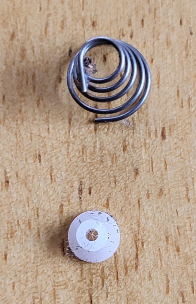

Trying to get my PMD740 up and running...
1) Engaging any function of tape transport leads to a quick self-shut-off.
2) Hitting play pushes some tape through for a moment, but it doesn't get taken up onto the spool.
3) Two parts had come loose and were rattling inside the case (see pic): a spring and a plastic roller/guide.
4) Unfortunately, the service parts diagram I found doesn't show these (that I can find).
This worked prior to moving, didn't have a lot of use (and was packed in the original box w/styro), so I assume that a bouncing moving truck somehow shook these two items loose.
Sure appreciate any help!
