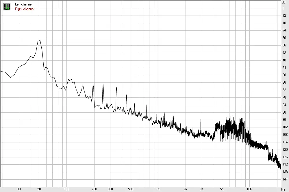

I have tried a attach a RighMark analyser spectrum of that noise but I cannot seem to get it to work.
The spectrum is however very odd. It is a near classical 6dB per octave low pass filter (HF cut) starting at a low frequency of 100Hz and falling to -60dB at 10kHz, There is also a big peak at 50Hz some 40dB above 100Hz! This 50Hz peak indicates to me either some serious magnetic coupling, power supply hum would be 100Hz, or most likely a hum loop.

It seems the attachment regime does not work with IE8 and XP?
The slope is nothing unusual. The 50Hz and the various harmonic products certainly look like line noise.

Why do you say the slope is not unusual please?
I have just run white noise(16bit .wav) thru RMA and got a dead flat 20Hz to 20kHz response.
The harmonics are weird, they are not 50Hz resultants.
Try pink noise or music. Pink slopes down pretty steadily and music often peaks around 100 or so depending on the style.
There seem to be response spikes at odd multiples of 50Hz: 250, 350, 450, 550, 750 and 950. Maybe I'm misinterpreting the graph.

Err? Pink noise falls at 3dB per octave (why it is not possible to generate it easily). I took the sample to be system noise and thus fairly "white" (my 2496 is). It IS common to see "one upon F " noise with a rising LF response but that only starts at about 100-200Hz, classic "transistor" noise.
You would expect 50Hz harmonics to land bang on 150,200,300 and so on...
Still! This all does not help the poor OP! I would like to track down that huge 50Hz peak?
There's not any real audio in that sample? I suppose I should have listened.
Well, I just generated a 50Hz sine and applied a distortion effect resulting in peaks at 150, 250, 350 and so on, sloping downward toward the HF. That seems a pretty good match for some aspects of the noise.
