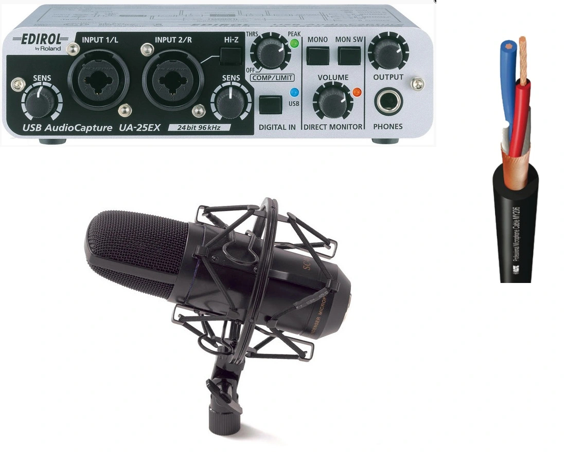

Is this your gear? Did you put ends on the cable? XLR?
yeah, as for the edirol's control panel, already checked that.
all sliders in cubase were also at 0dB.
What you say about the motherboard is interesting, I'll give it a try tomorrow, switching ports, I mean.
What do you mean "software pad is not engaged"?
Finally, the mic is positioned 2 cm from the "headjoint" of the flute, as it is called. It's the part of the instrument that resonates and actually produces the sound (basically, the spot where the airflow hits the instrument). Don't worry, I don't have the mic at the other end, it's not a clarinet, no newbie as far as flutes are concerned (though I wouldn't call myself an expert either).
Thanks for the suggestions, much appreciated! My motherboard is the Gigabyte P67A D3 B3, any idea if this could be the culprit?

The mic is the tbone sc400, large diaphragm condenser mic
The cable is the Klotz MY206 STEREO/BALANCED MONO 2-CORE (sorry, not allowed to post links, you can google them if you need more info)

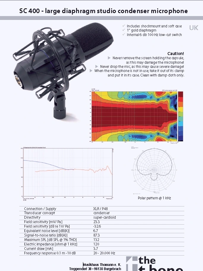

Specs on the mic.
