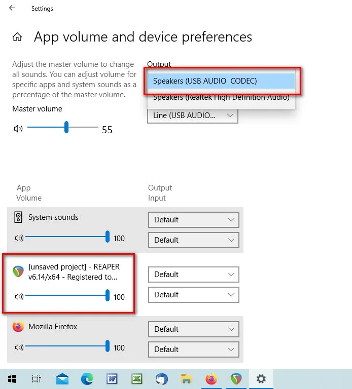

Just hooked up the mixer to my Win10 PC and got Reaper up. If you haven't looked at the Win10 sound settings, make sure of the volume settings as these may affect what gets sent back to the mixer (see attached image) Yes, the USB Audio CODEC is what you should be using, as there are no ASIO drivers for the mixer.
Certainly would have been helpful on Behringer's part to have a block diagram in the manual.
Screenshot is Advanced sound options at bottom of basic sound setting page
