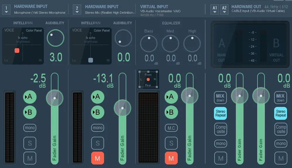

Hello,
I have just purchased a blue yeti USB.
The problem is that you can hear my TV next door, which is not great, because I want to start streams.
I would like the sound of my voice to be at the top top and without bringing my microphone very close to my mouth.
I set the microphone to the lowest GAIN setting and put the third option of the microphone.
I watched a tuto voicemetter and my voice is much better, but you can still hear the TV or something next door.
In the logic of things, we should hear that the front of the microphone (me) and nothing else...
I use a foam and I even tried the filter, but no difference.
I didn't buy a sound card, I use the one that is integrated with the PC.
