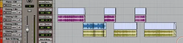

Pro Tools has been randomly selecting audio clip files in my projects to store in a folder outside the project folder, on my root directory, a folder it creates for itself, named "Pro Tools Projects". I stumbled upon this folder a couple of weeks ago and, because I had been relocating a bunch of PT files, assumed it to be stray files and deleted it. Over the following two weeks, multiple projects I opened were missing critical audio files, requiring me to re-record & rebuild these projects (see attached image to see the randomness of what I'm confronted with). I couldn't figure out why it was happening, then discovered PT has been storing half my newly generated files in the current project folder, and sending the other half to the folder it creates on my root directory, which I inadvertently deleted.
What insanity is behind Pro Tools sabotaging my projects this way? What on earth is going on with this program? It's doing this despite the Round Robin feature being turned off, and despite my specifically setting the disk allocation in each project to save files in that projects's folder.
