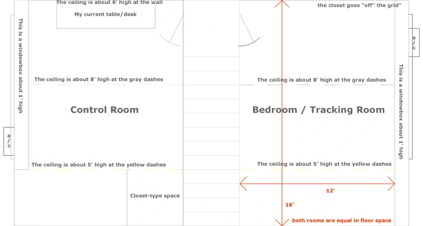

2. The rooms are shaped slightly different than what frederic may have pictured.
both rooms have the same shape where one wall is 6 feet high and the wall parallel to it is 4 ft. and the ceiling makes an upside down V shap goin over the room where the center of the room is 8' high.

A is the control room
B is the tracking/BEDROOM
C is the small space where the stairs meet the floor, there's about 4 feet between the rooms

I made a fairly accurate floorplan to help the visualization process...
Also I may consider swapping the tracking room and the control room altogether since I'd have to move my bed everytime I used it...
