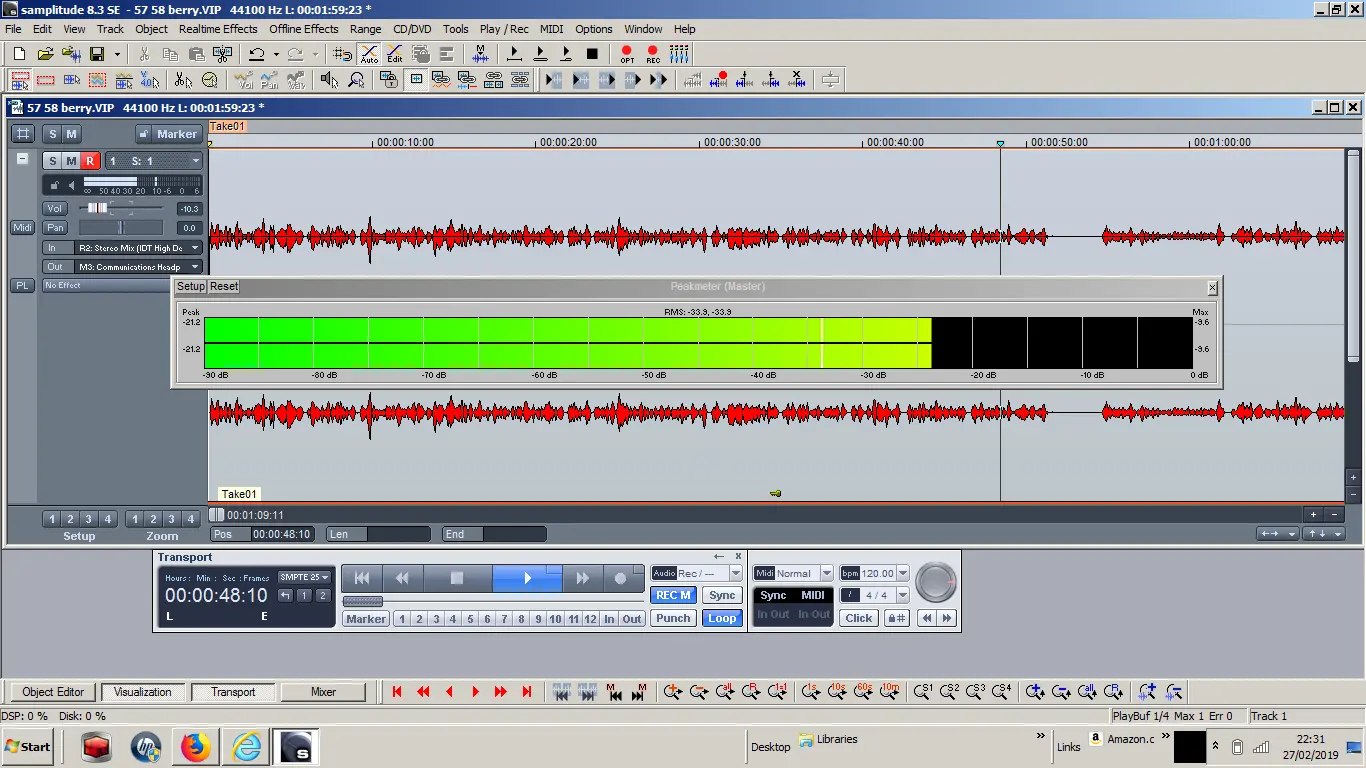

The guy on YT was running way too hot, touching 0dBfs at times so in the screen grab below I have pulled the level back to an average of -18dBfs. Sod's law prevails and the instant I hit prnt scrn it dipped below -20!
His shutted up noise floor was around -70dBfs after correcting the level which rather better than Dolby B cassette.
I am no great fan of Behringer but it cannot be denied that they make some remarkably good kit at stupid prices. I think at least one member here has a UM something?
