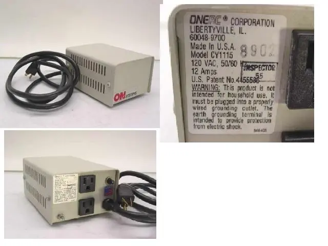

I found a guy that bought a pallet of power conditioners at an auction. And these can be had cheap, little 6 outlet boxes. His workers said I could probably have one for free....must have been 25 of them on the pallet.
A lot of factories closing, especially the semiconductor industry "chip" induistry, like Texas Instruments, who have piles of this kind of gear.
Korea buys a lot of the auctioned parts, as Asia is picking up most of the "outsourced" factory work....off topic.
there's a lot of used equipment vendors that buy and sell this junk as the plants are gutted.
