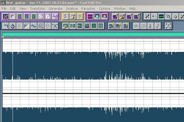

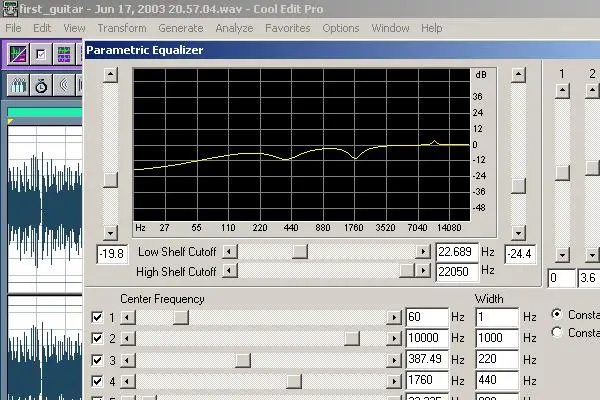

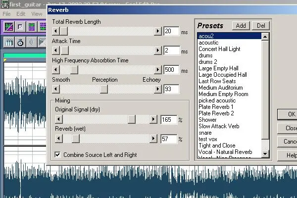

I have a real hard time explaining this stuff. I'm gonna post some pic's of the verb and eq setting's used (not preset's). I used the same compressor setting as i did for mix 1(pic on page 3) i think?
After i compressed and verbed the track's, it really shoot's the waveform through the roof! So i do a 6db cut before it goes back into the multitrack. It shave's off all of the peak's, and i mean flat!!! I'll post a pic of that too!

EQ for GIT'S.

Final "guitar" waveform after compression, reverb, EQ and a 6db cut!:eek:

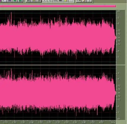

Here's a picture of the back half of your mix in my wave editor. As you can see, nothing is going over -1db, so no clipping, but it looks like you've got some headroom left if it weren't for those spikes...so just eyeballing it, I'd say it could take about 4db of input gain without getting too weird...I'll post the pic of that so you can see how it shears off music, lol...

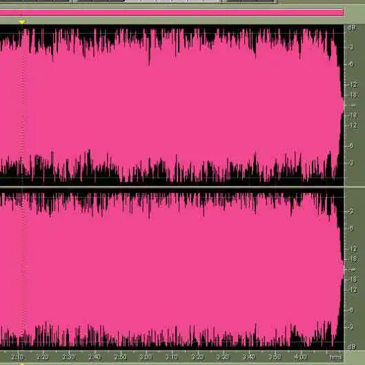

Here's your mix after "Hard Limiting" with an input gain of 4db and a ceiling of -.5db...(I like to be safe, lol). You really shouldn't limit all the way up to 0db, even though some say you can, b/c of the variations in different systems...most meters used by amateurs (like my software meters) are set a little hot anyway to keep people from going over -.3 (notice the decimal) - Glass Masters are apparently never supposed to be over -.3db, at least ... that's what I've read, but the new AudioSlave CD I got is totally clipped all over the place, with distorted drums on every track, and in addition to hitting my meters an average of 10db louder than any other commercial CD I have, it sounds like absolute shit....so don't go overboard, lol.
