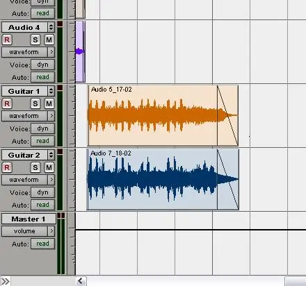

heres the wave form of my recorded guitar... im not using a distortion box or anything like that... my chain consist of guitar straight to amp, and mic on amp right to the preamp... heres a clip of the guitar

I know your problem, because the exact same thing happened to me. It's your cabinet. Try using someone else's cabinet if you can, because the bass on the Marshall AVT 4x12 is just way too loose, and can't handle palm mutes without giving you that spike in volume. When you play these heavy palm mutes, go close to the amp. Is there a buzzing, like something could be loose in the head? I think you may want to either buy a new cabinet, or at the very least consider putting new speakers in there. But it could be the construction of the amp that's killing your low notes.
i think your probaly right, guess ill just have to save up for the mesa, thanks
Something is too resonant. That being said, don't record with your EYES, do it with your EARS. I assume that it *sounds* unpleasant?
it doesnt really sound npleasent, it sounds like reular palmuting just it vibrates alot after i hit the note
I don't think the palm muting is the problem, but the whole guitar tone itself which isn't the best. I'm detecting too much treble, not enough mids and the gain still being a bit too much.
Recording direct doesn't help either.
No offense if this is all you have to record with. You *can* get good direct guitar sounds if you work at it though.
