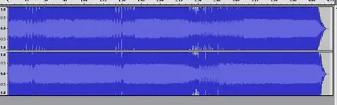

I can tell you why the kick drum hurts. Just look at the picture. It's completely squashed. I imported the song into Audacity see just how much... and there you go.

My overall impression is that it's a great song and a great mix. The problem I have with it is that I hear distortion throughout the entire song that I assume happened at the mastering stage when it apparently was squashed to death with a brickwall limiter!
holy schnikes this song is squished to shit! sounds like a great recording and performance, but man the mastering totally killed it. very pumpy on the kick and snare. the ME really needs to back off the limiter a little bit. it makes the song hard to listen to, and it's really a good song.

Yeah, It might be unbelievable... but the mastering before that was even more squashed.
I told him to lay of the limiting and the ''distortion'' but hey, it isn't my mastering ;)
But it is YOUR song. So the mastering engineer (the bitch) :) should do what you ask him to do.
