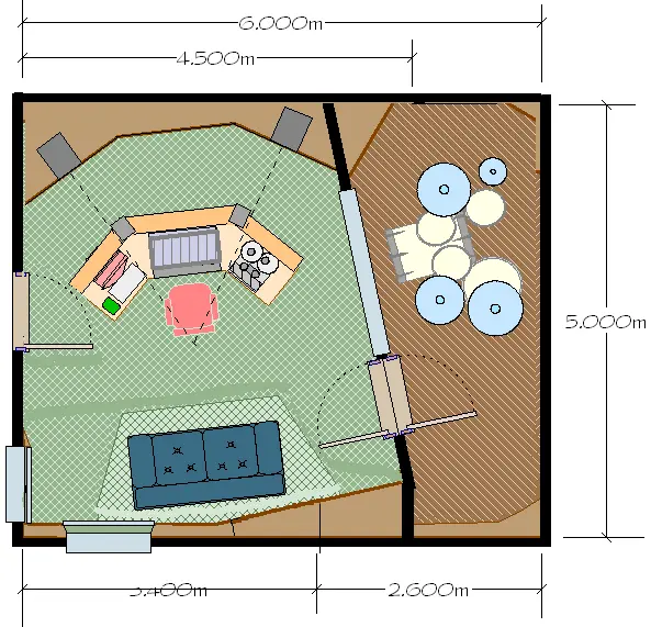

Also - would you please explain exactly how you are creating your floating floor so we can make sure there aren't going to be any problems there?

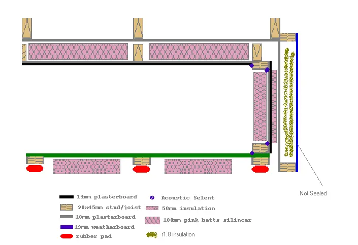

I don't consider the outside leaf as a leaf as it's not well sealed at all, so if I take this out of the equation my new total wall is Mass air Mass.
Heres a drawing of my wall plans, including ceiling and floor. I am using the inside out SAE wall because I am really limited on space as you can see from my floor plan!!
John,
I understand your thoughts on this - but you're mistaken.
Even if the leaf is not well sealed - it's still acting as a leaf - and the middle leaf will still diminish your isolation.
You would be much better off removing the inner layer and sealing the outer layer - perhaps adding some additional mass in the process.
If you cut the inner layer of drywall with a recriprocal saw carefully at the framing edge - you could reinstall it within the stud bay and caulk the edge to seal.......... same mass - only addition cost for the caulk - some additional labor - but a heck of a gain from the perspective of isolation.

Hi Rod,
thanks for the reply.
I suppose here in lies the problem.
I cannot touch the existing walls at all apart from caulk any airgaps and sealing the two windows in this room - this is part of the lease.
So my questions are:
(a)What can I do to provide the required isolation bearing in mind I can only afford one new wall with two sheets of 13mm board, i only have a maximum of 200mm in which to work and I can't touch the original wall which is already two leaf system - theres a tricky one for you!!
(b) I understand the principals of a three leaf system but if I have no choice but to build the walls these way what kind of % reduction in TL and/or STC will I have .
Thanks for your help - I am hoping there must be some solution or at least a compromise that is weighted in my direction.
