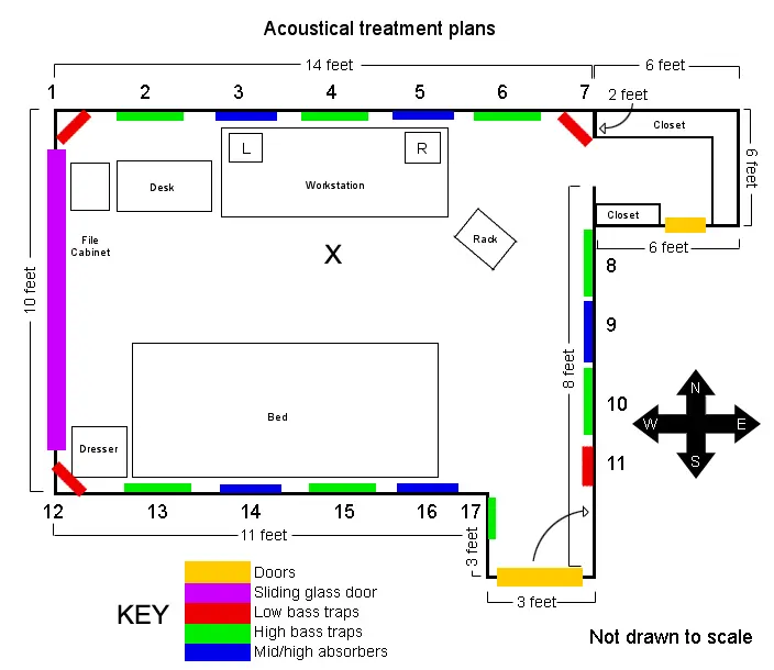

Hello everyone,
I am planning to do a treatment of my bedroom studio this summer by making some panels based on Ethan's designs.
My room has a few oddities which make things difficult. Firstly, the entire west wall is a sliding glass door. Secondly, the southeast corner has a little inlet where the door is, so there is no good way to place a corner bass trap. Thirdly, the northeast wall has an open space that leads to the bathroom with closets on each side.
In my current drawing, I have 17 panels (an assortment of each of the three types). I have placed them in the alternating fashion described in Ethan's article. In reality, I won't be able to afford that many. Probably 12 at an absolute maximum and hopefully no more than 8 or 10. I have labeled each trap with a number on the diagram for easy reference. The X marks the listening point.
My questions are:
1) Which of these panels are most expendable if I were going to reduce the total to 8-12 panels?
2) What is the best way to deal with the three problem spots?
3) Is there a completely different arrangement of panels that would work better than what I came up with?
Thanks very much in advance!

Perc,
For a room that small I wouldn't bother with wood panel traps at all. Just use thick, dense rigid fiberglass in all the corners, including the ceiling corners.
--Ethan

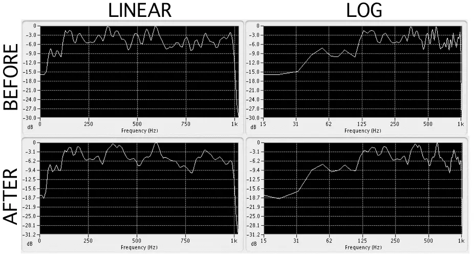

Okay, I finished all the panels and put them up. I put one on the back of the door and three stradling the other corners of the room. Four across the north wall, three across the south wall, and one in the closet for the vocal booth. It has deadened the echoes quite a bit but the room's frequency response hardly improved at all according to the test I did (same as Ethan's test as shown in the Realtraps demo video.) What am I doing wrong?

The panels are currently all 2" 703. I plan to change up the corner ones with 3" 705-FRK panels at some point when I have more money. Will that really make that big of a difference though, considering I saw little helpful change at all?
I tested the room's response by creating an audio file in Pd that plays a tone for every frequency between 1 Hz and 1000 Hz in 1 Hz increments, one second each. I then mic'ed my listening position with my R0DE NT1-A condenser and played the test. I did this before and after the panel installations and ran a spectrum analyzer on both of the resultant audio files. Here are my results:
You should use a omni mic for the test. Did you record it at the mix position?
T
Yes, I did record at the mix position. The only mics I have are the R0DE NT1-A condenser and the Shure Beta 58A, neither of which have polar pattern controls. So between the two of them, I figured the condenser would pick up the best sound.

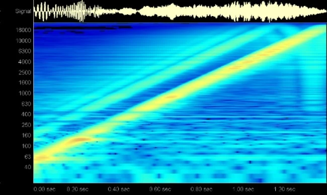

Perceptes -- is there a freebe software for spectral analysis I could use to produce plots like you? I just recorded a sweeping test tone from my mix position I'd like to plot. All I have is this visualization (time vs. frequency; the amplitude is color coded) :(

Perce,
> I plan to change up the corner ones with 3" 705-FRK panels at some point when I have more money. Will that really make that big of a difference though, considering I saw little helpful change at all? <
Yes, going from 2 inches to 3 will make a difference. I have no explanation for the tiny change, but I will mention that the measuring microphone needs to be in the exact same place for the Before and After tests.
How does the low frequency response sound in the room? Can you hear a difference in fullness and low end clarity? Does the bass seem more even around the room?
I'll also echo what the others said about needing a proper measuring mike. Though I would expect any change in the response to be accurate, if not the absolute numbers.
--Ethan
The one I used for that graph is the spectrum analyzer built into Cubase SX. I just found a free plugin that does realtime spectrum analysis, though: Elemental Audio's Inspector. The PAZ by Waves will do the same job but even better, and you get a 14 day fully functional trial when you install it.

The mic was in the same position for both tests (within a few inches since I had to move it out of the room while we set up the panels.) There's not much I can do about the mic itself, no more money for another mic at this point.
From my first impression, the bass actually sounded weaker than it did before, but I will have to do another test as far as its evenness across the room. I am also concerned that the high frequencies may have been deadened a little too much. Is 12 panels in one room too many for the room dimensions I describe in the original post? Thanks.
