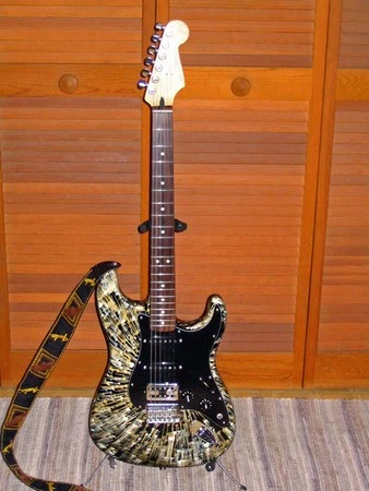

I have a Fender Strat thats made in Mexico that I installed 3 GFS pickups to replace the original ones and they are a lot better sounding, the bridge pickup is a Liverpool RetroTron that is similar to the Dream 180. I have it wired for coil tapping, it just takes a DPDT switch and a humbucker with 4 conductor wiring. I'm not sure of the bridge spacing problem though..
The GFS pickups come with some vague wiring diagrams-I recommend Seymour Duncan's site for more exact diagrams.
