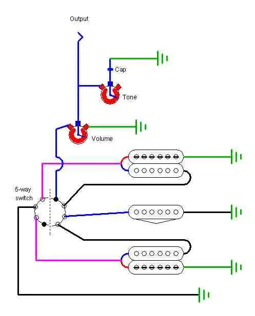

The STK-4 is a stacked humbucker; so yes, it is a humbucker, but it is not a "full" humbucker. It is not as wide, so it doesn't pickup as much of the string as a full sized humbucker. To me, they sound closer to a single coil than a humbucker, but they are not all the way in either direction.
If I were you, I'd do it like the attachment on this post. It will give you a simple 5 way switching system, but will give you some cool options. First of all, it will automatically coil tap the two humbuckers in the "in-between" settings, which will give you something much closer to a Strat sound in those positions while still being hum canceling, but will give you the full humbucker in the neck only and bridge only positions. As far as mixing cable types, don't worry about it; it's is not a problem, as long as you know what you are after from your guitar.
