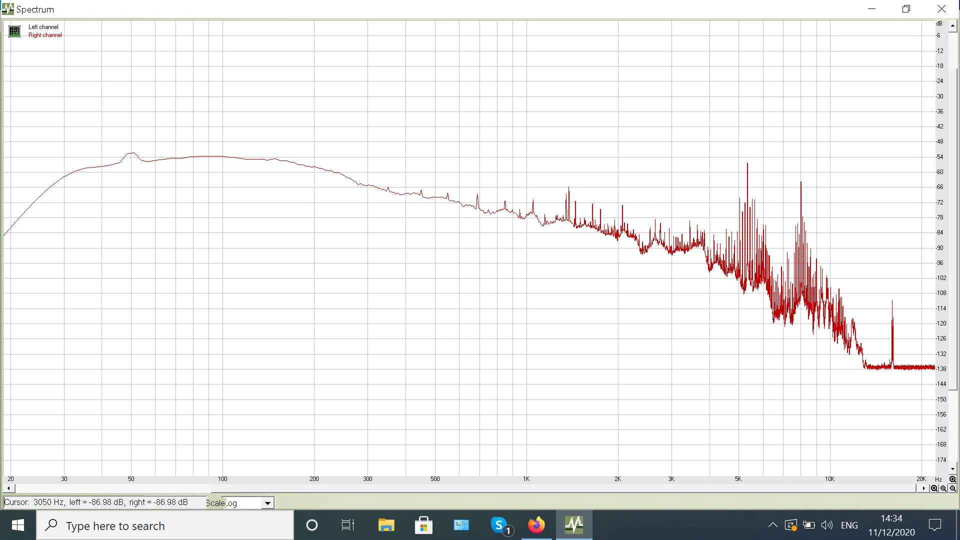

Oooo! That's messy!
If you hadn't said it was something decent I would have put that spectrum down to a ***t converter of the type you get in cheap ass mixers.
Can you try recording at different sample rates? I assume you are running 24 bits?
Could be some form of digital 'ground loop' but I confess I don't see how.?
