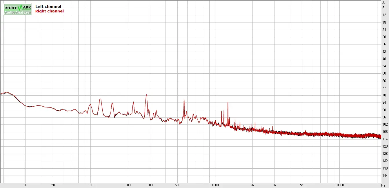

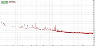

I don't know what you would class as a good result Mack but attached is some waffle into a BM 800 plugged into the jack on this HP i3 upon which I am typing.
By my lights the sound is not at all bad for a sub 20 quid microphone!

It sounds just fine Dave for a $23.00 mic. When I brought your file up to a -18LUFS from a -27LUFS, the background noise was around a -49.9dbs. The ACX has a max of -60dbs. This would not be a good mic to record Audio Books with.
"This would not be a good mic to record Audio Books with. "
Well no! But then you would not record the books with a bast'd noisy computer in the room! The fan whine is at about 280 Hz and some 30dB above baseline noise plus decaying harmonics.
The purpose of the exercise was to show that a good sample of the mic is easily good enough for 'podding' or rock yodelling where the signal would easily be some 20dB higher. I would bet the combination beats a dynamic and many a cheap AI pre amp. I had a £50 USB mic and the BM was on a par (both are now in France!)
I did not check the mic on a high SPL source such as a guitar amp but I suspect with only 5volts or so for the impedance converter it will not be brilliant. The wonder of the mic is that it works as well as it does and the build quality is really amazing for the dosh.

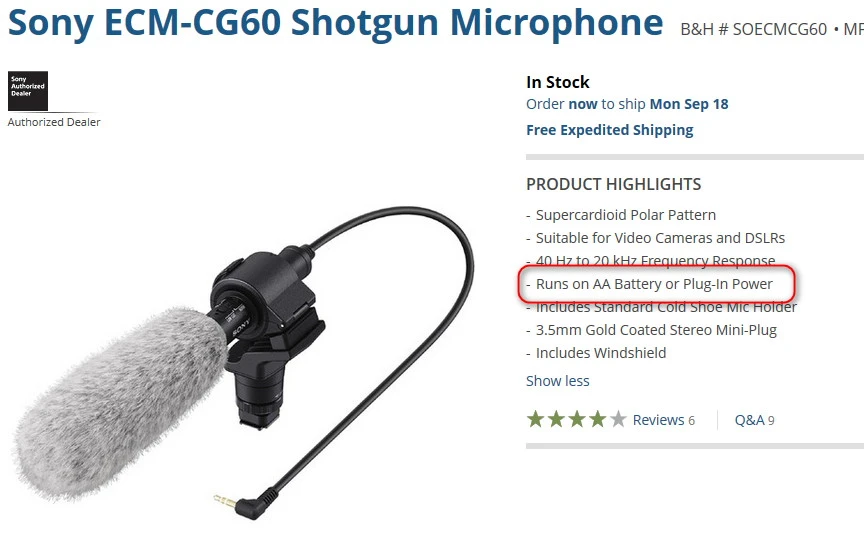

These Amazon/eBay 'studio' mics such as what this thread is about, generally have electret capsules which can run on plug-in power, but have electronics that can throttle down 48v phantom to be able to power the mic. I've seen one or two versions of these sold that actually used internal AA batteries for power.

I remembered a couple of decades ago, there was some sennheiser Shotgun Mics that could run off of batteries or p48
