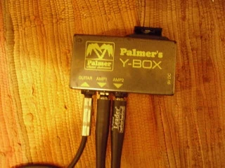

I can concur on both of Boulder's suggestions. The Y splitter cable goes to your two outputs (pedals, amps, DAW/recorder, whatever). Likewise with the Palmer Y box resize ybox.webp. You plug the guitar into the input and send the two outs to wherever you desire. I frequently use the box on the bass when I'm going for the 'three bass sounds at once' option {miked amp, line out and DI} and it's great. Sometimes though, depending on the time of day or part of the house I'm in, it picks up foreign radio stations or police broadcasts and can be a real pain in the patootie. But only minimally.
