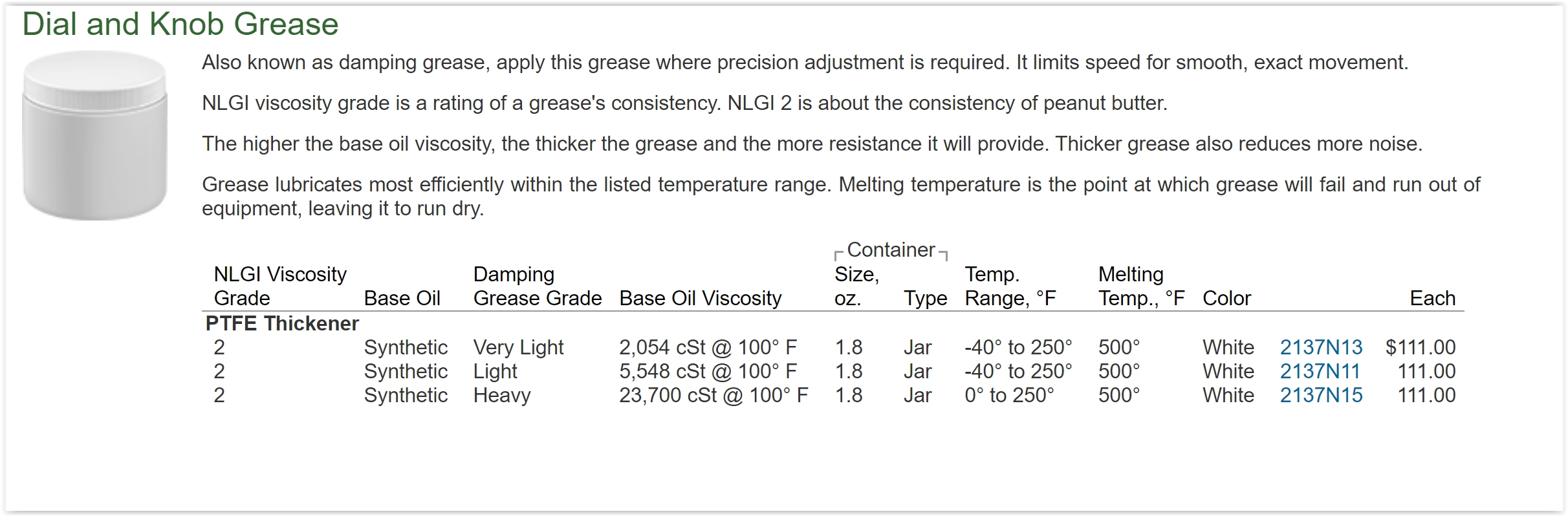

Damping grease aka high friction grease. McMaster Carr or Amazon if you search high friction grease. Higher end equipment had mechanical dampers.
Holy crap is McMaster overcharging but it was the same way when you bought manufacturer specific products. Being authorized to do warranty work required specific products, test gear and training. Shop was authorized for a lot of various brands. Each one had their peculiarities.
Holy crap! That's the same size as the one I found for $19.99 on Amazon. I understand about warranty procedures, having to use required OEM stuff.
