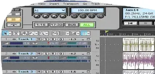

The Track or Edit view in GT3 is primarily used for setting envelopes, cutting & pasting etc, rather than bus assignments. Anyway, here it is

I guess I'm not going to be of much help to you here. I am not familiar with GT. I assumed the layout was similar to Sonar, but apparently not.
In Sonar, at the bottom of the Track View page are four tabs - All, Mix, FX, and I/O. I can't tell from the view you posted, but from your comments it appears that GT has a different layout.
Seems that there should be a way to pan the send. Maybe you can try the GT forum on the Cakewalk site.

It could be that GT just doesn't have this feature (which is kinda dumb, IMHO). However, I noticed that the GT Console View only shows one knob in the Aux Bus area (for Send Level, I presume), whereas in Sonar there are two knobs (Send Level and Pan).
