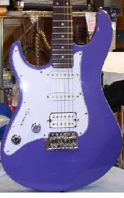

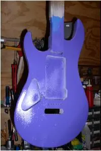

My friend painted a DuriColor Car spray paint, small cans, on my MIM Strat.
He called Fender and it was PolyEsther or something, like POlyEurethane but stonger. The stores like GC want thick stronger stuff to reduce nicks and dings. He said it was a bitch to work with, sandpaper wouldn't hardly move the clearcoat poly-E crap.
The Laquer was from WalMart too I think, or Auto zone.
He also painted the Purple Yammie...spray paint and laquer, and about 4 weeks of sanding!
Its beautiful. Then the MIM will get a new Lime green or crazy color my kid wants.

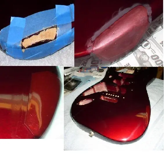

Here's the MIM repair pics. It came out fair. Not as good, as the purple Yammie, which was like a glass coating...beautiful.
but compared to the original damaged condition...huge improvement. This thing had a deep gouge of wood gone.
Its barely noticeable now, unless held up in the light close up.
From 3 ft the gouge is out of sight. The car paint DuriColor was a bit lighter shade, as Fender wouldnt sell the Wine-color paint for our repair. (the patch is underneath the arm when playing anyway.)
Soon its going Yellow or Lime green or something crazy.. ;)
A Brand new MIM, damaged for about out the door of $200, it's mint shape other than the gouge.
My friend only charged like $10 or some cheap price + paint of course to fill and paint and polish.
I have the paint cans and laquer spray can. He did the homework on calling Fender and all that. He repairs and paints, and puts together, custom ordered pickups for "musicians without time or soldering type skills".
the woodwork is more of a enjoyment thing.
The second pic shows how sturdy the MIM Fender clearcoat is!!
