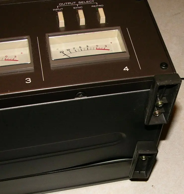

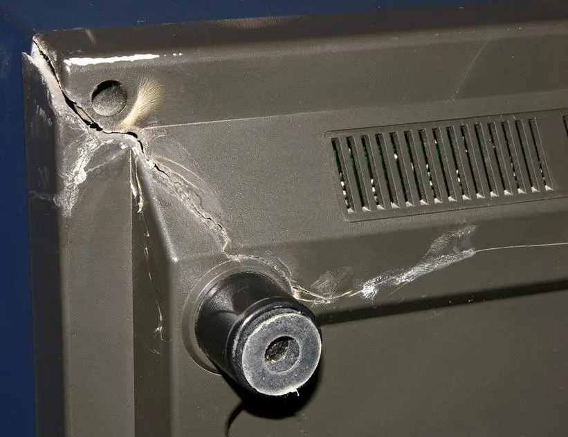

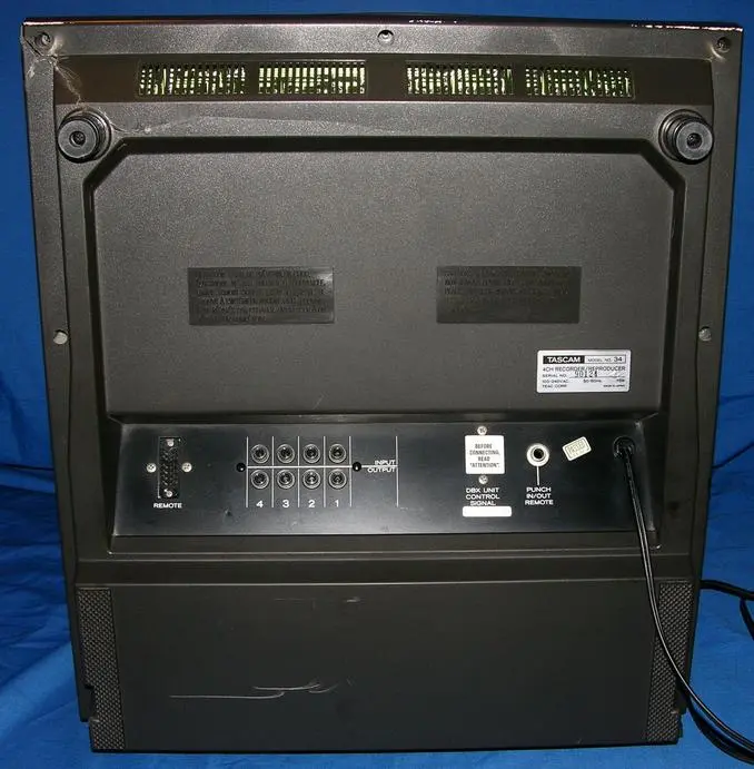

Here's another one which got bashed in shipping...
.......a TASCAM 34 :(

It should be a Crime! :mad:
I wonder how many more will be destroyed through the eBay meat grinder. There won't be many left at this rate. :eek:
Maybe we could start a vintage gear preservation group. If the seller doesn't have our stamp of approval... that is, promise to pack the item at some minimal standard, (something like the Square Trade agreement) he would be considered high risk.
Education with some teeth. Maybe even a list of repeat offenders, patterned after the "List of Bad Tapes on eBay" (which I need to bring up to date, by the way) ;)

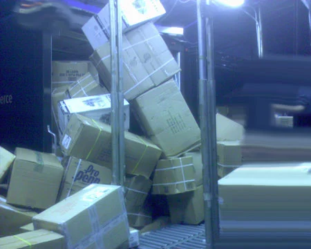

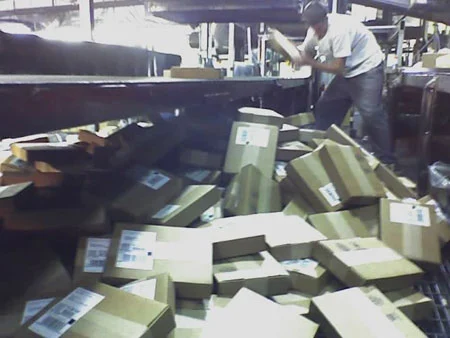

In my experience, most package damage occurs in the building; in the crush of overloaded belts, stacked in tractor trailers, and smashed by sorting diverters. Contrary to popular belief, most of the damage doesn't happen during human handling.
It is also worth noting that UPS outsourced its Customer Service soon after it began to be a publicly traded company. Previous to that, customer service had been an in-house job. So now it's just another subcontracted boiler room phone job. The people answering the phones there wouldn't know a UPS package from a sack of grapefruit.
I'm posting a couple of pics here from inside a hub. Believe me, these are tame and not half wrecked as the inside of the building looks during a busy shift. Neither cameras nor camera phones are allowed in package areas of the building. I don't know who snapped these pics, but if they'd been caught they would have been fired.
In my experience, most UPS hourly employees would prefer to provide better service. Management and their quest for numbers simply won't allow it.
