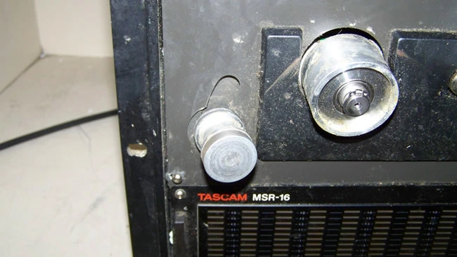

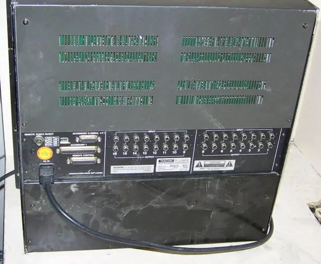

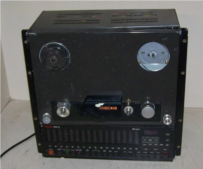

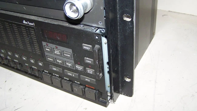

Packing 101 (read this if you want your recorder / mixer to arrive in one piece)
damaged during shipment
Won't people ever learn?:eek::confused::rolleyes::mad:

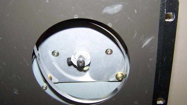

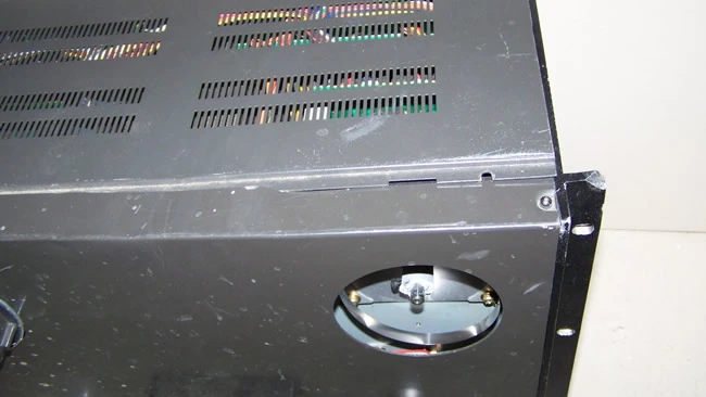

A couple more:

Classic!
This item was damaged during shipment as shown. iT pwoers on, the controls respond as they should and the play,ff,rew,stop functions work well but it has not been tested with a tape. :eek::eek::eek:;)
Yup, it's hard to tell who the biggest moron is, the seller trying to auction off this thing [with a retarded description] or the one who originally packed this unit!:eek::eek::rolleyes:
