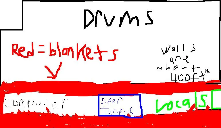

True. Well If its not the most amazing thing ever, its not worth redoing the whole studio. im looking to get some better stuff than that shitty super tuff r I have. Anyone have an suggestions I could spend my summer pay check on. I am only 16 so I dont have much, but Im willing throw what is necessary to make this happen. Let me know guys. Thanks, i truely appreciate it.

But now im greedy and want both acoustical greatness, and for the room to be silent instead of very loud (Its a half wall room, not a closed door room).
Hmmm, silent instead of very loud? Are you talking about "soundproofing"....ie...keeping environmental noise from entering the recording space as well as keep LOUD music from transmitting to the other rooms in the house as well as from the neighbors? If so, "treatment" does absolutely nothing for sound transmission through the building assemblies. All it does is absorb sound in the room itself. Sound TRANSMISSION is an entirely different animal, and requires a whole different set of solutions...namely...mass and lots of it, sealing all air leaks, and flanking paths such as ductwork, decoupling when required, and many other techniques/materials. If this is what you are talking about, don't confuse foam/fiberglass treatment with "soundproofing"...they are entirely two different concepts.
fitz:)
True. I mean I have like a 1000 dollar budget which is not great but decent. I do not want to have to make anything though. It seems like if i buy that Knauf board or even 703 I am going to have to put together something which I am not savy at. The guy at GC told me that with my budget he would sell me some basic bass traps for 35 ea and a bunch of 2'X4' 2'' thick auralex foam pads for 27 ea. I do not know if this is a good deal but it just seems so easy compared to making stuff. He said all I have to do is spray the auralex and then put it on my walls. However, if I am spending this much money I do want a very nice sound. The following is an awful drawn picture by yours truly. The room has a halfwall that we will be filling with sheetrock. For now, curtains with a curtain rod on both sides have been hung up to stop some noise from ruining the noise. The end with the computer has the computer pushed against the wall with curtains on both sides and behind super tuff R. This gives a very small separate control room. On the opposite side of the super tuff R is the Vocal booth. This has curtains on both ends with a mattress against the wall and supertuff directly behind. The red in the picture is the curtains that we sewn using a bunch of different materials and are pretty thick. The last section is the drum room which is the rest of the room and completely empty besides the drums. It is just a big blank room. So, any help for layouts would be appreciated and any ideas will be used. If real pictures are needed, I will have to do it.
Edit: I just realized in the picture that the drums are pushed much more in the right corner. They are cornered in that right corner. However, the room is drawn large in my sketch so just imaging the word drums starting 2 inches before the D and ending right by the right corner. It should really be this.

It's easy enough to add some sparkle back into a room. It's much harder to deal with the LF than the HF.
For this reason, I think one can't have too many bass traps.
OK so I def need bass traps. What else based off the layout of my basement. I have a carpet flooring and sheetrock ceilings.
