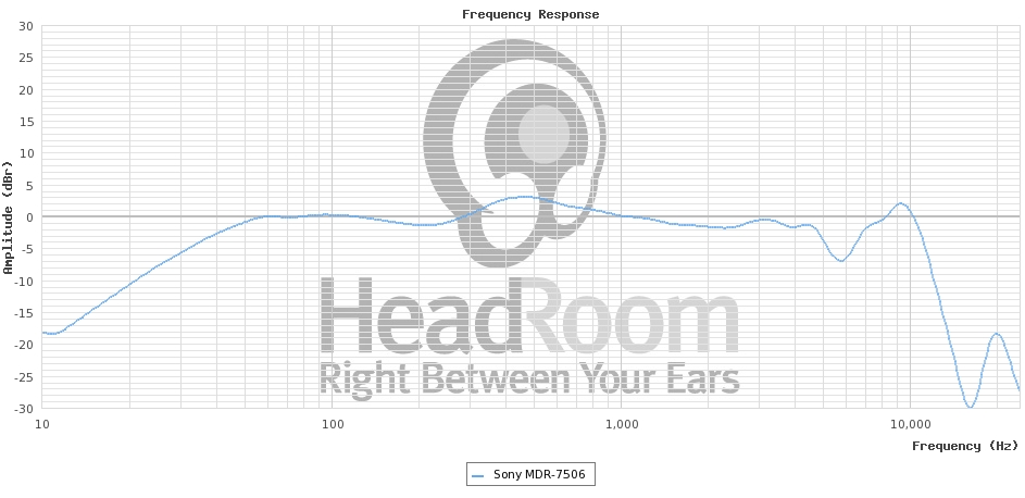

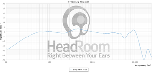

Here is a freq plot on reasonably flat fones;
