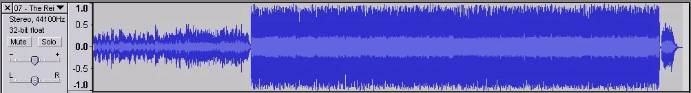

The time for images of waveforms has probably passed, but here's an interesting one. This is from 'The Reincarnation Of Benjamin Breeg' from Iron Maiden's most recent album.
The clean intro is actually quiet rather than hard limited at -4dbFS or whatever and it encourages you to turn the volume up.
Then, of course, the heavy comes in and smashes you in the face. It doesn't look totally 'bricked' but it's not far off.
If this was a normal top 10 pop song, would the quiet intro be totally smashed so it was peaking even though it's soft?

Dynamics are a crucial part of a song. I don't care if it's Beethoven, or Black Flag. Over compression or limmiting is just not acceptable to me, and thats as a listener. You can tell when a track has no dynamics in it.
There's musical dynamics and there's dynamics in the mix. The dynamics can be achieved with the arrangement just as easily (more effectively) than the mix.
The only time it's okay to over compress any thing is if its to achieve a desired effect.

A slightly topped off but uncompressed track with a hot snare mix will look like a brick' if the tempo's high enough.
good point. Pretty much every death metal band I've done a mix for ends up looking like a brick.
Also, I use a lot of synths through bit crushers and shit...so that could contribute as well.
If everything's loud, nothing's loud. The problem is that being 100% intense, all the time, is what most bands are going for (at least in my chosen genre of Metal). You can't mix/master-in dynamics if they're not meant to be there due to "creative" decisions by the band. Thus, if there aren't any dynamics in the first place, there aren't any to take away by mastering. I really think it's more a sign of the production style people are into and the song arrangements bands/producers are choosing, vs. any issue with mastering. Sure, you can take limiting too far and make the mixes harder to listen to, but if the band is going for a super-intense, super-in-your-face, unrelenting, incredibly loud, incredibly dense sound, you'd be doing the material a disservice by not smashing the shit out of it.
That's what I was referring to earlier; if all it takes to make a brick is a couple of dB of limiting or other squashing, you pretty much have a virtual brick to begin with. This is understandable, not a criticism. When the content is a wall of guitar sustain and distortion joned by Animal from the Muppets on the cymbals and a triple kick traveling at 220BPM, not only does that stuff have higher RMS levels and low crest factors to begin with, but don't have to squeeze the turnip very hard to get the last ounce of blood out of it. It's the nature of it.
While that still does not mean that the last drops of blood do need to be squeezed out, that's kind of besides the point of the loudness wars. When one has delta blues, pop, space rock, country, etc. etc., works which are nowhere near bricks when they come out of the mixing ovens, and squashes and pushes them in the same way, *then* one has...or maybe at least should have...some objections to smashing the shit out of them.
It's funny how everybody who has been around the block more than once knows there are no recipies when it comes to mic choice, EQ settings, compressor settings, etc., that is up to us to listen to the music and let it tell us what to do...except in final mastering volume levels, where it's OK to treat everything the same and squash the life out of it no matter how it protests.
G.
Because a giant square wave NEVER sounds as good as a normal feather duster wave. It's not what it looks like that matters, you're right. But when it looks like that, it's going to sound like crap no matter how you parse the argument.
It's like saying, who cares what the lines on the seismograph look like, as long as there isn't an earthquake. Well, if the seismograph is drawing squarewaves, there's an earthquake.
