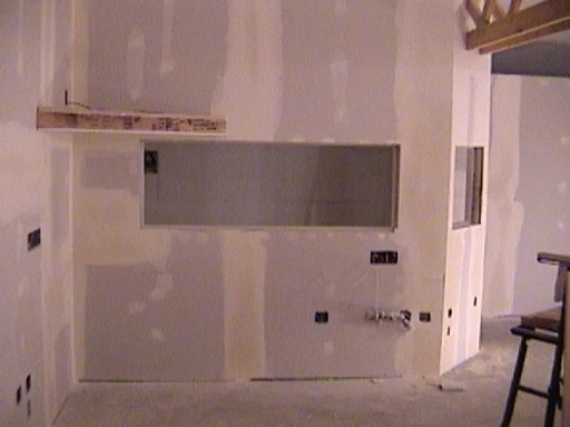

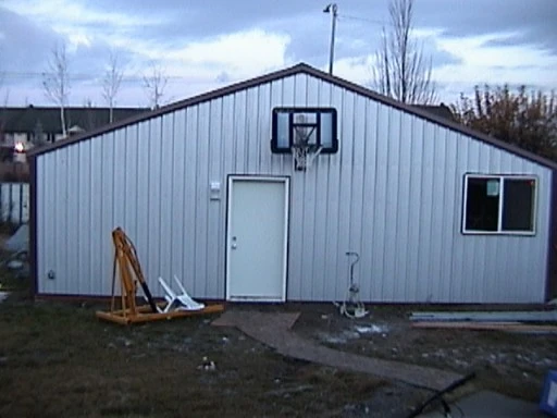

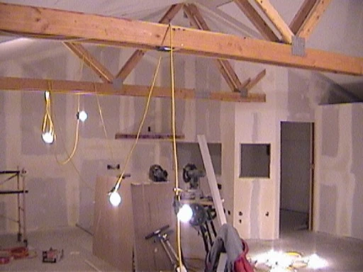

These are some current pics of my jam room/ studio....

Looks pretty cool. I like the high ceilings.

Want to come over here and do my drywalling? ;)
There is a builder in Spokane that does all the main big commercial jobs. Hes an elite contractor. He built this "castle" looking office and requested my buddy to personaly do the finish taping. My pal is that good. Me and him shared a business together for a little over a year. I learned to tape and finish sheetrock from a real pro. I hate it. But I can do it pretty well.
The only thing I didnt do personally to my building is pour the floor. Kind of a good feeling, I guess. Saves the denaro`.
Being an electrical contractor came in handy for the wiring! :D

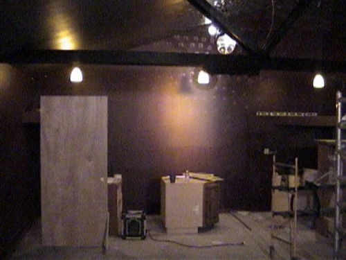

An update.
I paint tommorrow. Then lights, then carpet.

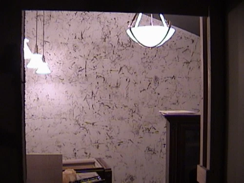

Just finishing painting, hung a few lights. Here is a terrible picture..
Carpet today and tomorrow! I have my turning drum stage! Ill take some photos of everything in a few days. I cant wait to plug in and turn it up past....Oh... :rolleyes: 2, and ROCK! :D
