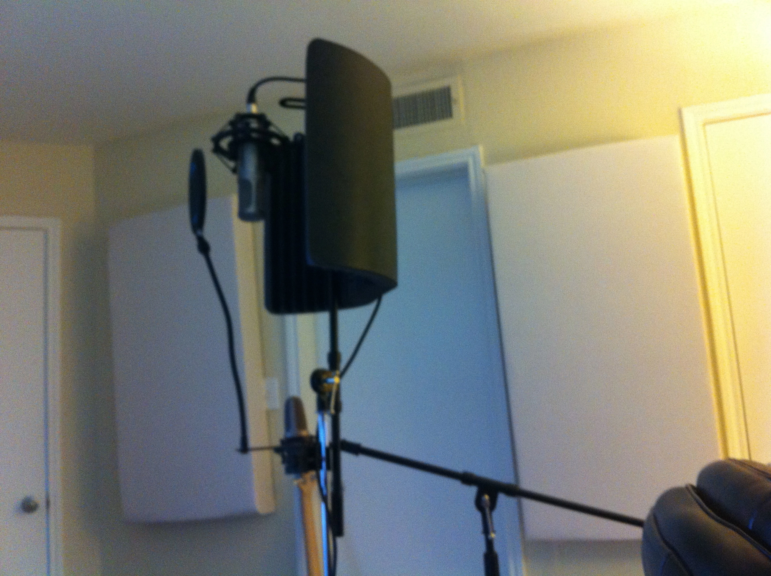

12 more 4" panels coming soon...in shipping now, also a nice pic of my new Rode K2, next will be better non ported monitors and a monitor switcher.

You may have some symmetry issues with reflections off the slider. A free-standing portable absorber you could put in front of it may help when doing critical listening. With what you have already the room should sound much better.
I know am thinking of heavy lined curtains for the door. Would panels be better?
