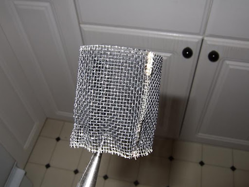

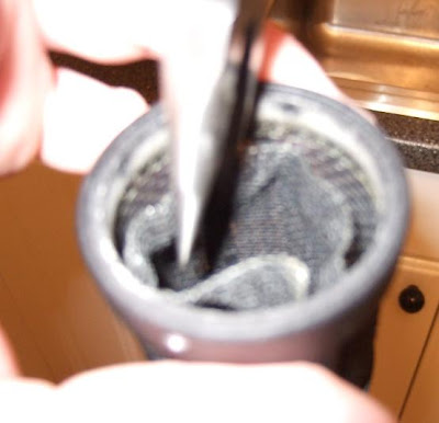

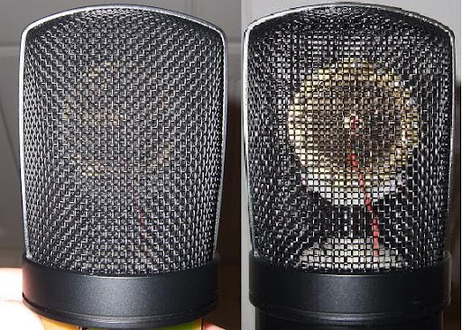

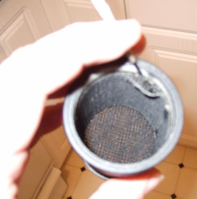

My suggestion: Do the headbasket and disk mods yourself.
The inner mesh just sits inside and is not connected (welded/soldered) so all you have to do is pull it out with small flat head screwdriver and a pair of needle nose pliers. It will take all of 5 minutes.
The resonater discs: Loosen the fours screws that hold them in and then just snip the discs at the holes and where the wire to the capsule goes in on the front with a wire cutter. Tighten the screws back in and you're good to go.
