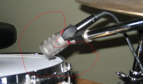

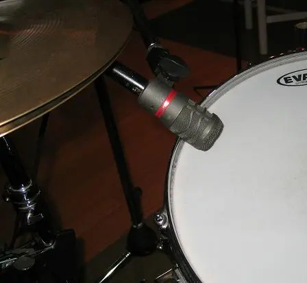

Here is a pic - it's not very good, as my kit is set up for my 8 year old, so the hats sit about 1" higher than the snare, and you can barely get a mic in there. I use a hyper cardoid ATM23HE.
Ok here is a better pic - remember, the kit is set up for an 8 year old, so there is very little room between the snare and hats. I drew the cardoid pattern in red (and yes, it looks like a first grader did it :eek: ) It actually has more rejection on the "lobes" than I drew, but I suck at drawing in paint! :D
Notice though, they rejection zone is pointed directly at the hats.....
