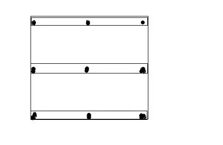

mshilarious i was thinking of attaching the velco like this, on the back of the frame atactch wood strips and mount the velcro on them. u think this would work. thanks again..i'm excited about building them now.
btw the little black dots are the velco
If it doesn't work, add more velcro!
